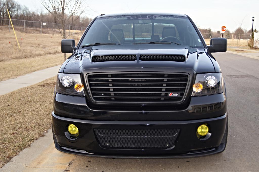

I have the SuperSnake bumper that just slipped over the metal one. I think one in your color would look great:

WoWeeeee Man.....
Looks fantastic!! If you don't mind me asking, how did you handle the alignment? I'm racking my brain trying to figure out the best approach to handle my alignment....excess negative camber causing inside wear after dropping my FX4.
Thanks and you've inspired me to do some more upgrades!
