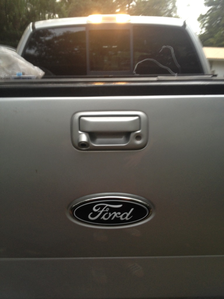

I have done a lot of searching and reading but have not found a suitable answer for my situation. I have a tailgate handle camera purchased from tailgatecamera.com. It requires a power source at the rear of the truck, but I want it to be on all the time.
I have already stripped and put the voltmeter to the wires in the 7pin harness but none get power unless a trailer is plugged in. I have tried the orange acessory wire in the back of the harness and multiple ground points but to no avail.
I dont want to wire it into the reverse lights as I want to be able to view it all the time. So where do I pick up power? At this point I think I am going to have to run it back into the cab and find an ignition activated power source.
