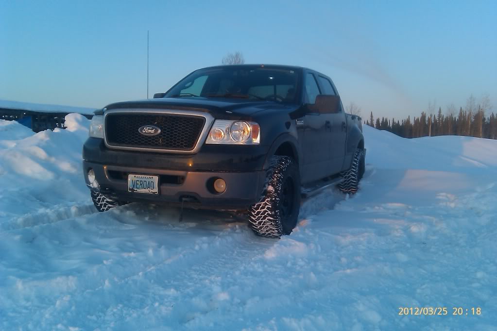

He was also told that his cam phasers are starting to go... they sound fine, no unusual noises or rattling. But the dealer wants $2800 to replace them and the PCM...
His truck has about 94k mi on it, but is a fully loaded Fx4 screw/flareside. I don't think he wants to trade it in yet since it's fully paid off.
What would you guys do?
