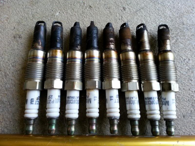

Plugs are done.
Took me about 2.5 hours taking my time. None of them broke, used a very weak Hitachi 12V impact. I did not pre-loosen any of them up except for number 8 which the impact would not remove with the universal joint and an extension.
1-8 in order

so other than the carbon deposits the plugs looked fine
went out this morning while it was still cooler and I had no issues, something must have been wron

It was time - the gaps on those old plugs look pretty wide.

They seem wide when brand new. Are the pregapped?
