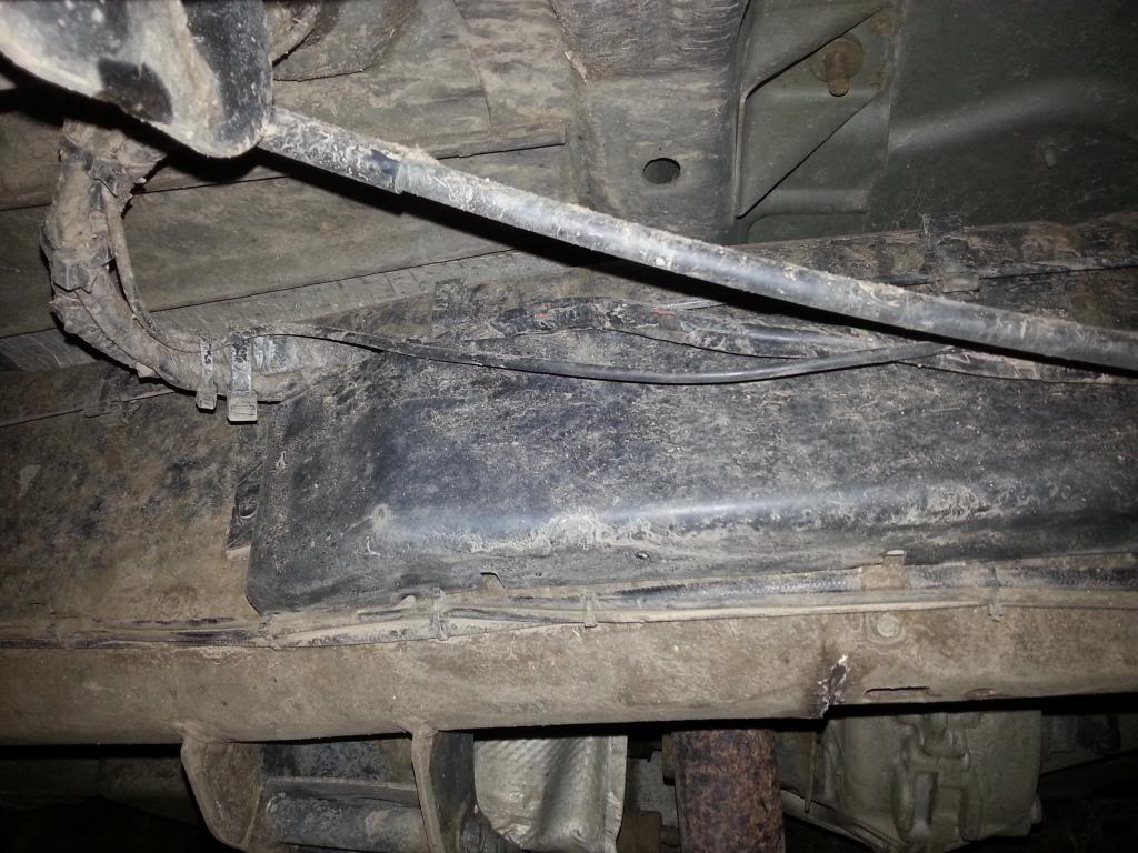

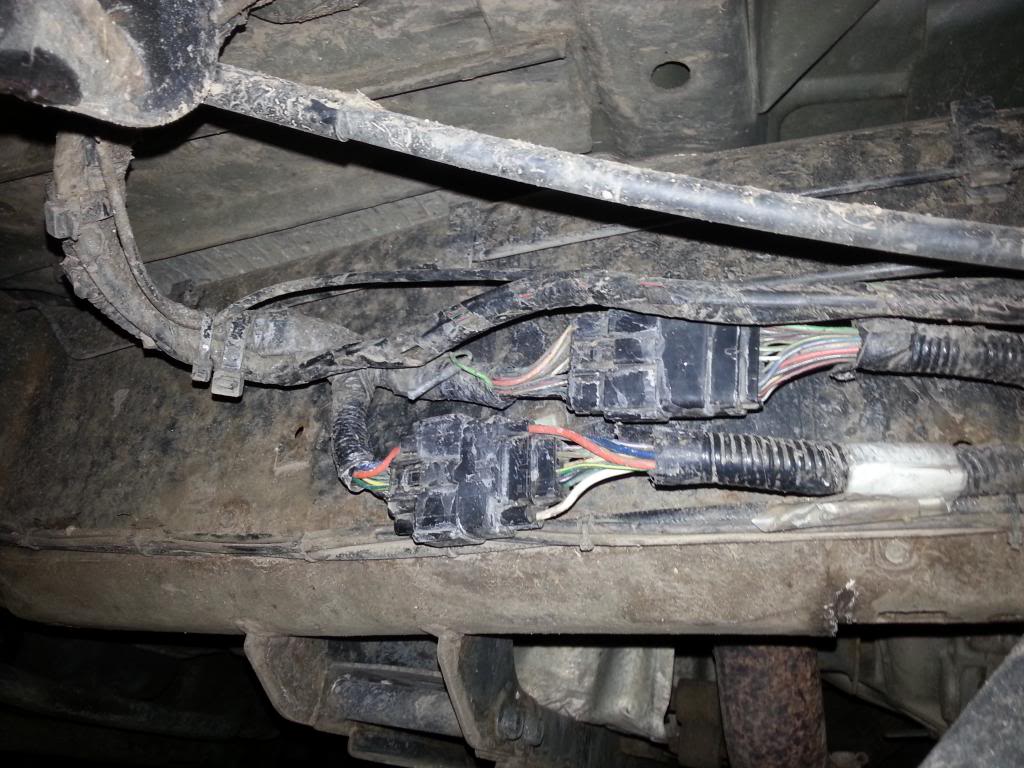

Here is a photo of the location, I should add that there are actually 2 multi connectors, there are around 20 pins in each connector & I believe that they should both be replaced as there are signs of corrosion in both.

Viewed from below the drivers door, you can just see the transmission crossmember

When I first had a problem with the gas guage & also the rear parking sensors last year I found that the cover was competely full of dirt as it collects everything that comes up from the front wheel. I cleand it all out, drained the water from the connectors & sprayed them with contact cleaner, everything worked fine for 6 months, but recently we have had some pretty bad weather here & now I've got problems again.

Holy mackerel, they sure put those in a bad place didn't they? Even covered they get a lot of crap in there. I'm quite sure my '04 doesn't have anything like that, but I know they changed a LOT of the electrical in the '07 because my SIL has one and it's a lot different than my '04 though the truck looks the same.
