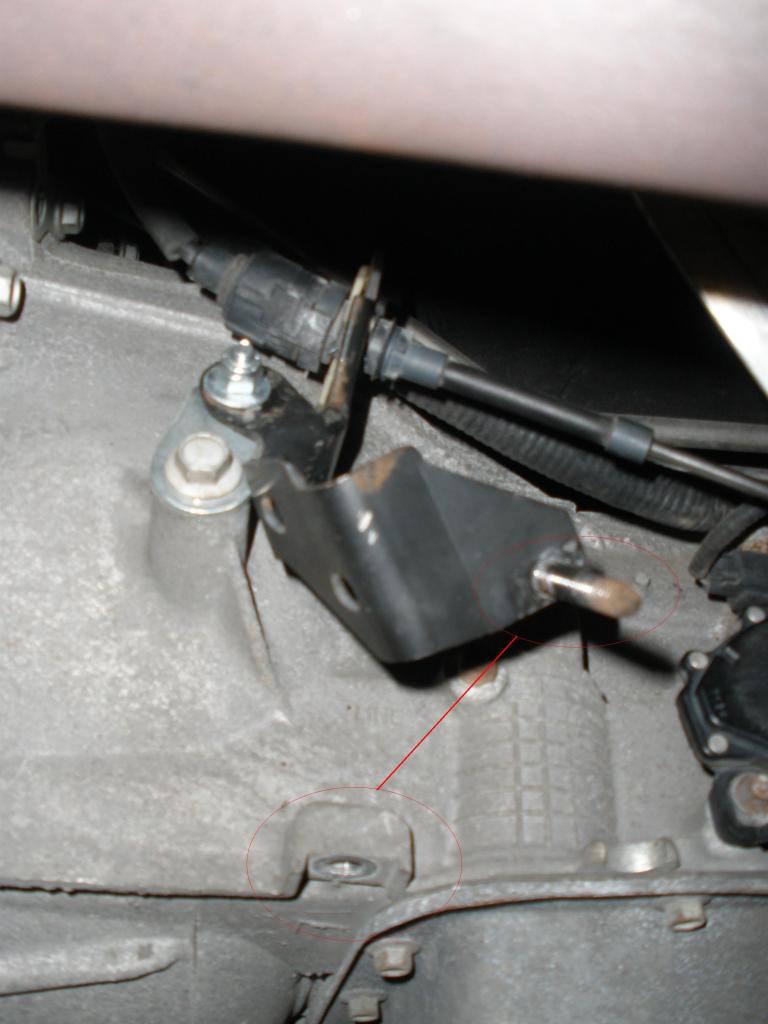

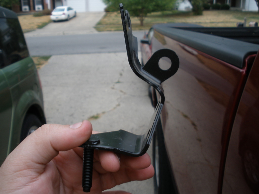

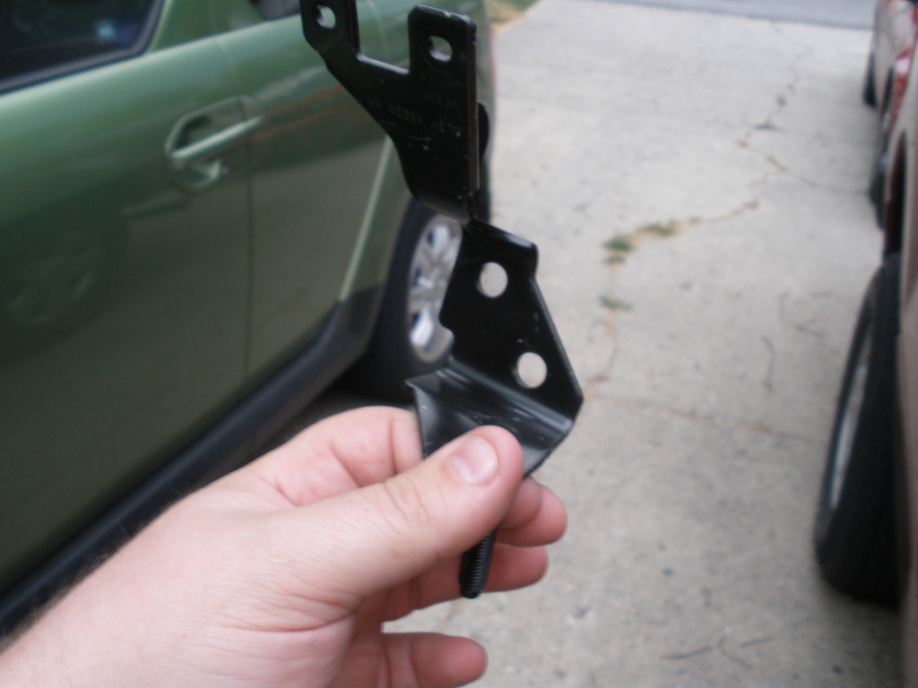

First I'll show you the original bracket that I bought another of.
In this photo I show where the original stud mates up to the transmission.

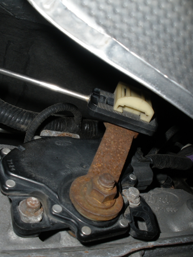

Is this part adjustable?

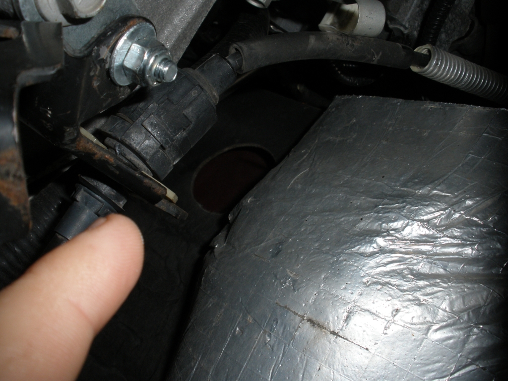

Here is where it ends. Don't know if there's anything can be done here.

Yea I had the same problem!! I had to cut the stock bracket and weld that one on had to do some modding but I got it to work. Also took me 30 min to figure out what hear I had it if after I installed this piece cause it somehow it shifted out of park
