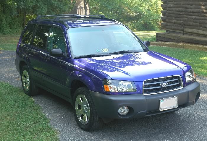

When I purchased our Subaru Forester in 2007, it had damage to the rt frt fender / hood / grille / head light. Estimate was $4400. 55,000 miles, 5 spd, just needed fixing and cleaning. Book was $13-14000. I paid $3500 for it, lady had sold it to a wrecker driver friend because she had cancelled her collision insurance after paying the loan off 2 weeks earlier and could not afford to fix it.
I fixed it for $2300 in parts including new fender, hood, grille, AC Cond & Charge, HL, bumper cover, fender liner, paint for hood and fender, and $90 in plastic push pins of correct sizes and type at Subaru (used all subaru parts). I used a comealong and chain to pull inner fender and radiator support back straight into alignment. There was no frame damage.
In case you missed it, that was $90 in plastic push pins.
Wife loves it, just put a new set of tires on it, 28-32 mpg, good power, and those push pins are still holding here 4+ years later.
