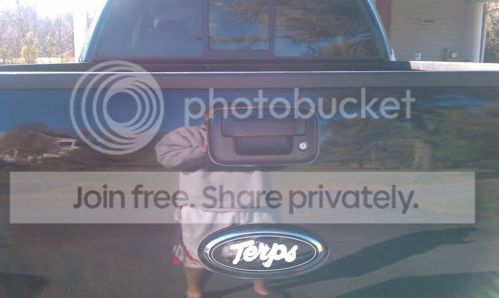

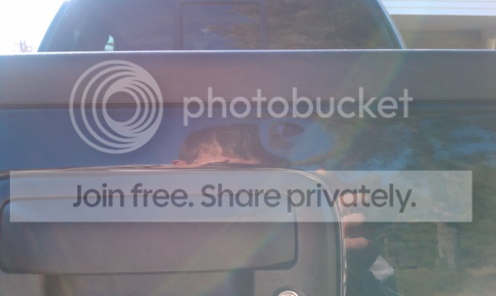

So while packing up my truck to go hunting I noticed a small dent right above my tailgate handle. The dent is about the size of the end of my index finger. It is also scratched, but seems to only be a surface scratch as my nail fails to catch on it. I'm posting some pics of it (not the best, sorry) to see what you guys think I can do about it. I'm thinking I can remove the handle and pop the dent back out. (HOPEFULLY). What say you??? Thanks!!!!

my guess would be that your stuck with it. looks to be in a bad spot for fixing it, but then again, i really dont know.

Try the painless dent remover companies. They can get to the back of the sheet metal from the tailgate access panel and may be able to get it out without doing full body work and a repaint.

paintless dent removal i have used these companies and in most cases depending on dent location and access they will remove it like it was never there.

^^ OR take the tailgate off and take it to a good body shop and have it repaired and repainted.
Few years back I had a tape measure sittin on my bumper and opened my tailgate. Yeah nice crease. Took it to a good body shop, left them my tailgate. Few days later and $225 I got my gate back looking good as new. Till this day you can't notice anything not like you do with dent removal. So it depends how good you want it to look and the funds.

A paintless dent guy shoud fix it for $30-$50.

Go to any decent body shop - if they don't do PDR ask them to recommend someone. The body shop I use calls a guy in when PDR is requested.

Try a dealer lot (Ford, etc) with a used car lot. Often they have their trade-ins detailed by a 3rd party that comes in every so often and many do the PDR. They should be able to access from the handle or back of tailgate without much trouble, and with an experienced tech you'll never know it was there.
