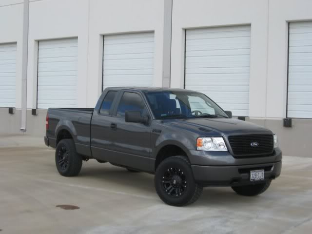

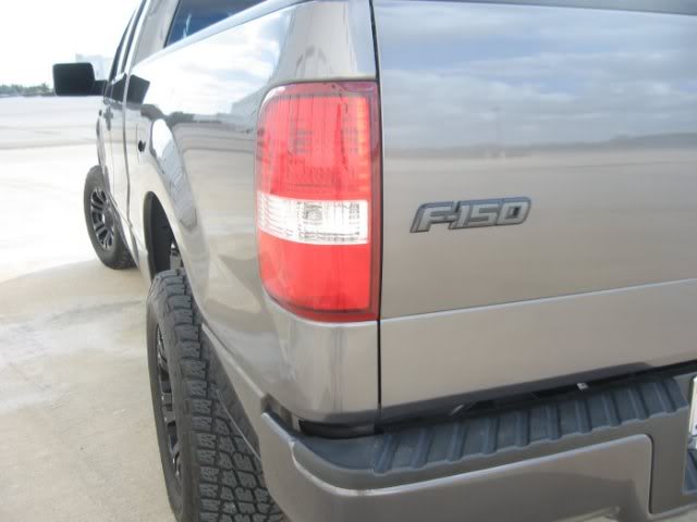

I've got a 2wd with a 2.5 autospring leveling kit up front, and a factory 4x4 block in the rear. Tires are 285/65/18 nitto terra grapplers. Rims are the typical xd monsters 18x9 with -18 offset. Barely rubs the front valence, but its easy to trim and you cant tell I touched it. I also have the 4.6 with 3.55 gears, and the truck seems just fine to me.

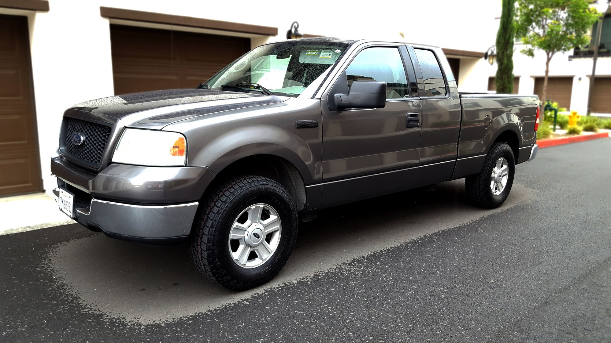

<center>BEFORE</center>
<center>AFTER</center>
33's Nitto Grappler G2 A/T
3" Leveling Kit

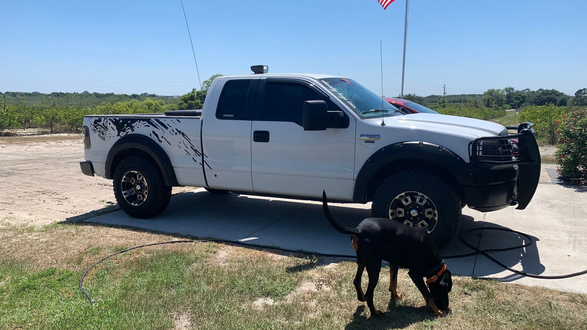

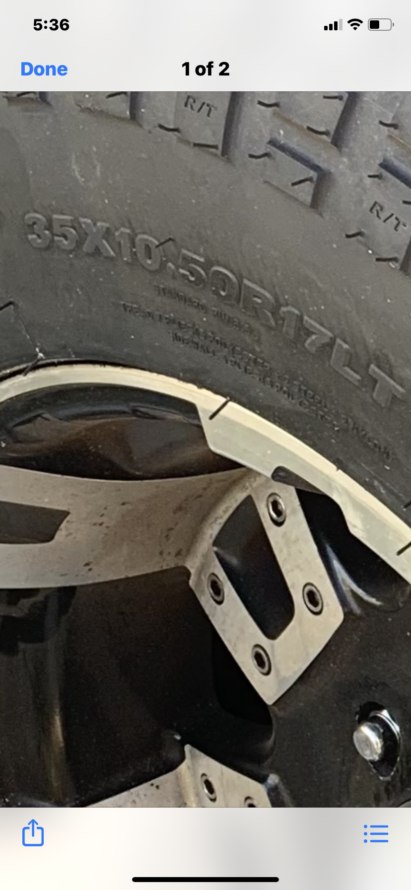

Old May 26, 2021 | 10:07 AM
MrHarleyHall's Avatar
Joined: May 2021
35s on a 2wd
Originally Posted by CaliKid
The time has finally come and im over riding on stock wheels and i need to make some decisions. I want to go with 20" XD Monsters and Nitto Mud Grapplers, but after seeing some pics I really want the 35's and dont mind trimming the inner fender. Should i be safe and go with 33's or go with the 35's and not look back if possible. Any pictures of 2wd f150's with 33's or 35's would help out a lot, and any other comments that will lead me in the right direction would be sweet such as rubbing issues and needed backspacing...
35s on a leveled 2wd
