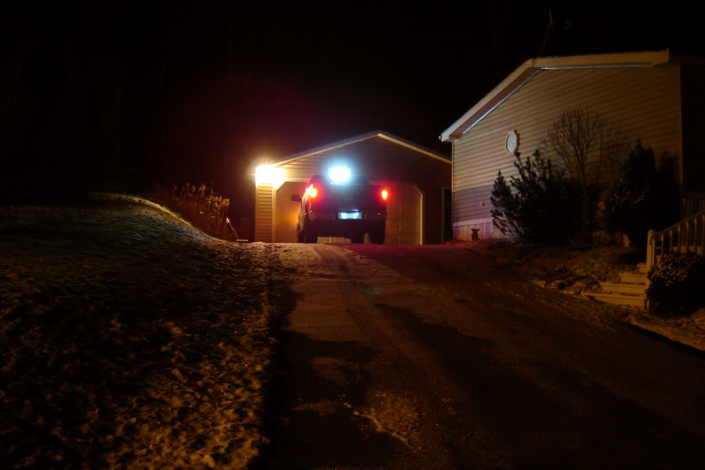

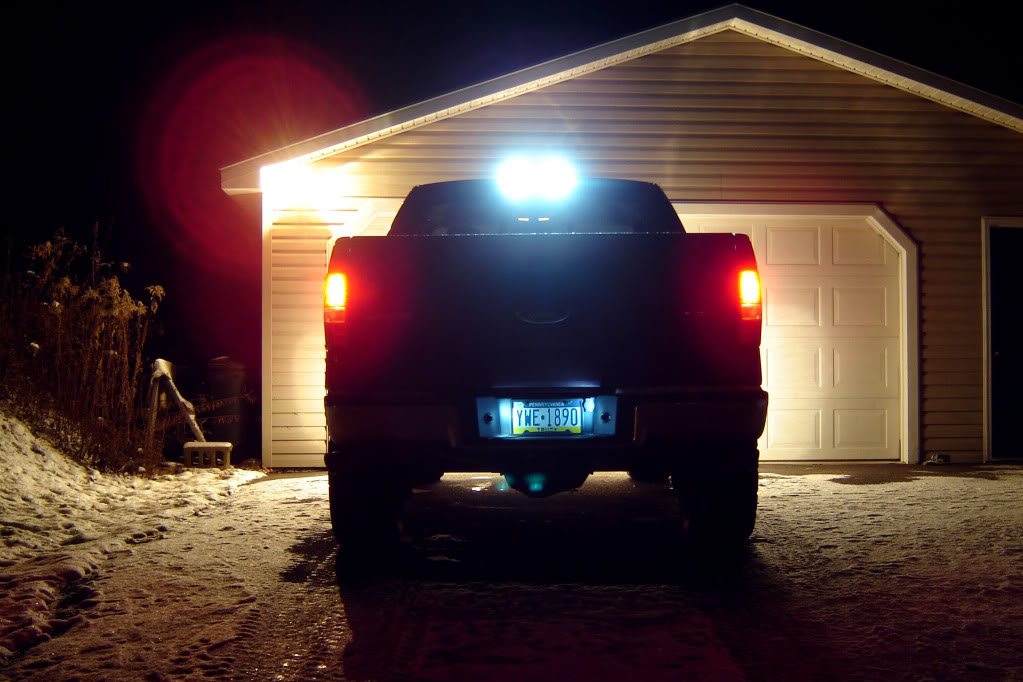

Originally Posted by blackjack8900
What does eveybody think of these for the reverse lights?
http://www.v-leds.com/Exterior-LED/P...81029-1-2.html
I would say get something with more side firing lights.
Originally Posted by mkinttrim
Just completed mine and what a difference! I ordered 2 of the packages of the map lights not thinking that there are 2 to a package so I put the extra 2 in the front side markers.
Has anyone replaced their cargo lights bulbs?
I have, but I bought my bulbs from Auto Lumination. The equivalent bulbs from v-leds are too expensive imo. The cargo bulbs are #906 bulbs.
They illuminate the bed very well, but no better than stock.
