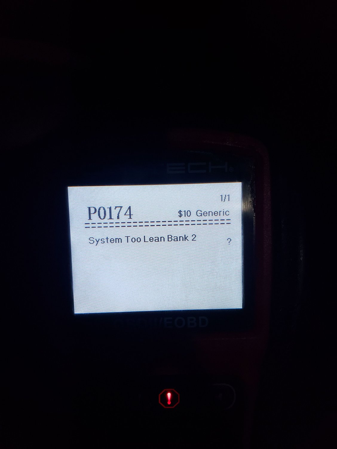

P0174 only code, nothing else pending
Honestly feels like running on 7 cylinders
More towards the end of the video you can hear it being more pronounced

Check for vacuum leaks. An exhaust leak before the upstream O2 sensor can cause a lean code. Pull your plugs and look at them. Do a compression test while they are out.

Jim,
The 174 code is lean bank 2.
It has little to do with plugs, wires or valves.
It is excess air in the intake for bank 2, or it can be an air leak just ahead of the front Ox sensor bank 2.
Either fault will be detected by the Ox sensor and shift the long term fuel table 'rich'. This set's the code.
Your giving up because you don't understand the situation.
You then become the bigger issue and do yourself in.
Re-think this, go back and check out based on what I explained and good luck.
I have been there and know this.

I just addressed the code only.
He has to do the rest whatever has to be done.
A misfire from lost ignition passes more fuel and air.
A lean condition sets a 174 code even if you include un combusted air to add to it. ..There are still 7 other cylinders firing IF that is the case.
You can't have a rich and lean code for the 'same bank' at the same time with only one Ox sensor doing the detection.
174 is shifted long term fuel tables Rich due to a lean intake condition of a false air leak ahead of the Ox sensor.
I don't know what he has, he doesn't know either.
The code does not lie.
