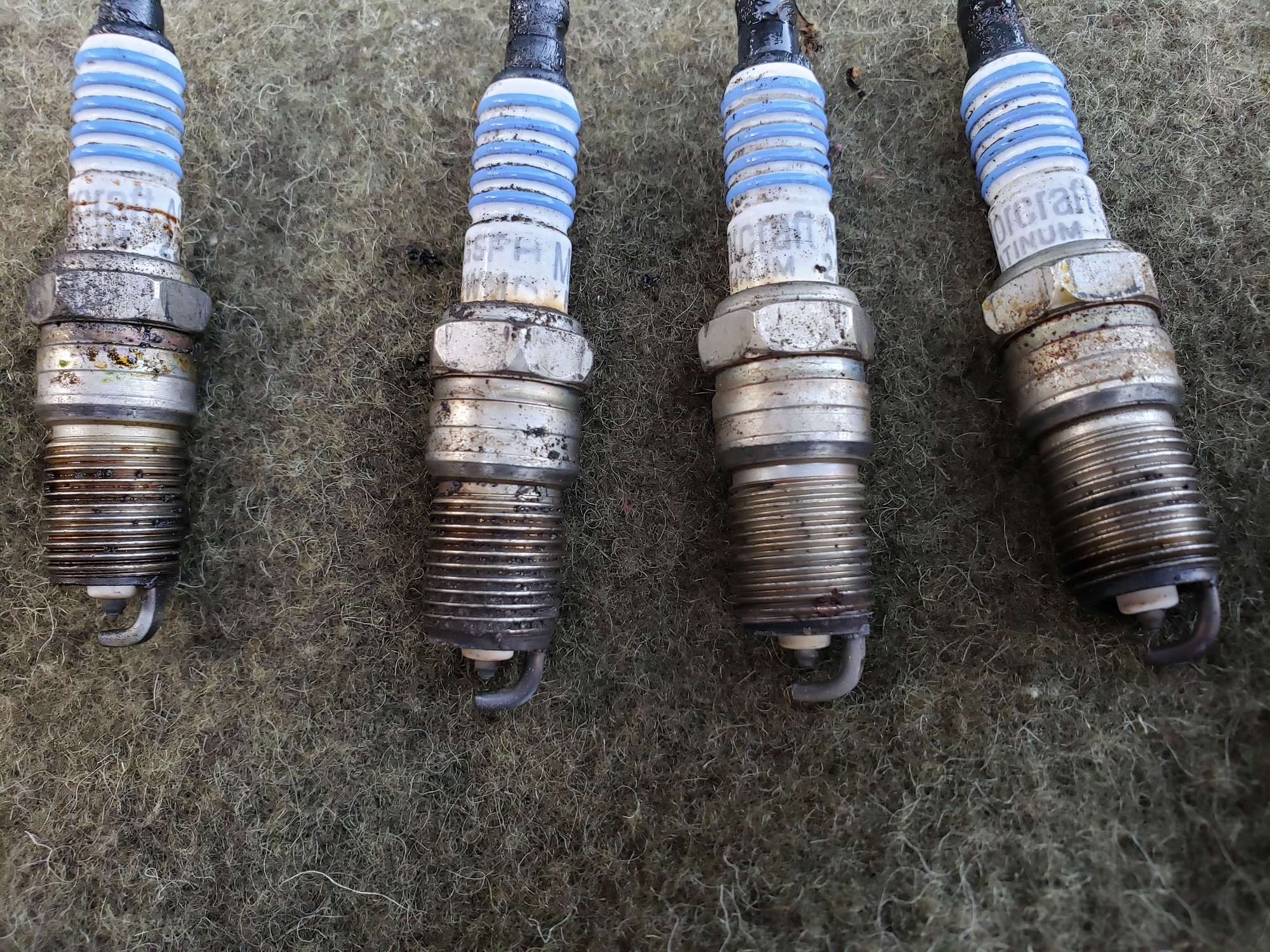

Ok, so starting to work on it. All right/pass side plugs are out.
Left most plug is the front of the engine. Then so on.
They look all about equal.
Some look a little wet, but that is because I discoed the fuel rail for better access and it dripped gas all over the place.

How do the plugs on the other bank look?

Not sure. Only got the passenger side pulled. Don't have any more time to mess with it today. Actually posting this, while supposed to be getting dressed for work, haha
