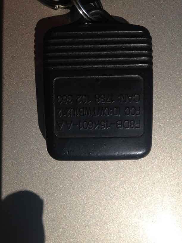

If I don't use the unlock button on the fob or use the door keypad the theft light will just continue to flash every 2 seconds when I put the key in the ignition. Here are the pics.

That definitely looks to be Ford factory.
