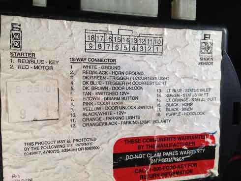

I had some time to do some more looking at the add-on security I found the valet buttom and the security box, but don't which company it is from to know how to program it. I took a picture of the back. Does anybody which security system this is? Thanks

That's a Ford dealer installed system. Again. refer to post #4.
