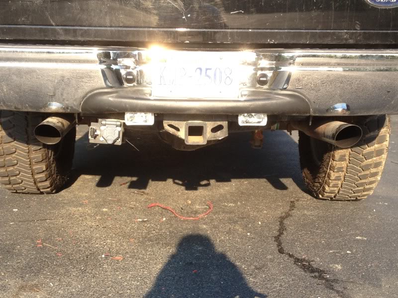

First: Position your lights where you would like them on the back of the truck. I actually tack welded mine to the steel towing bar. I wanted to position them so I could fold them upwards and be out of sight from people, and also keep the lens from getting damaged driving.

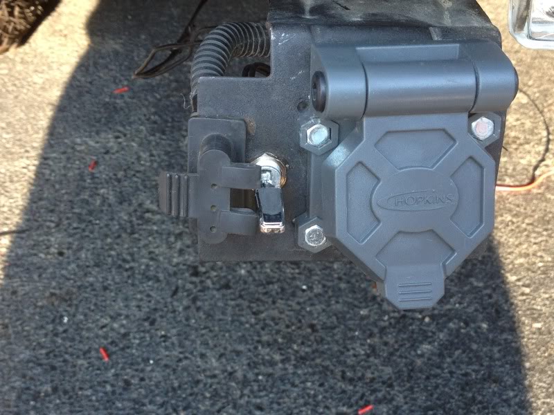

Second: Mount your External 30-amp Switch on the tow harness bracket.

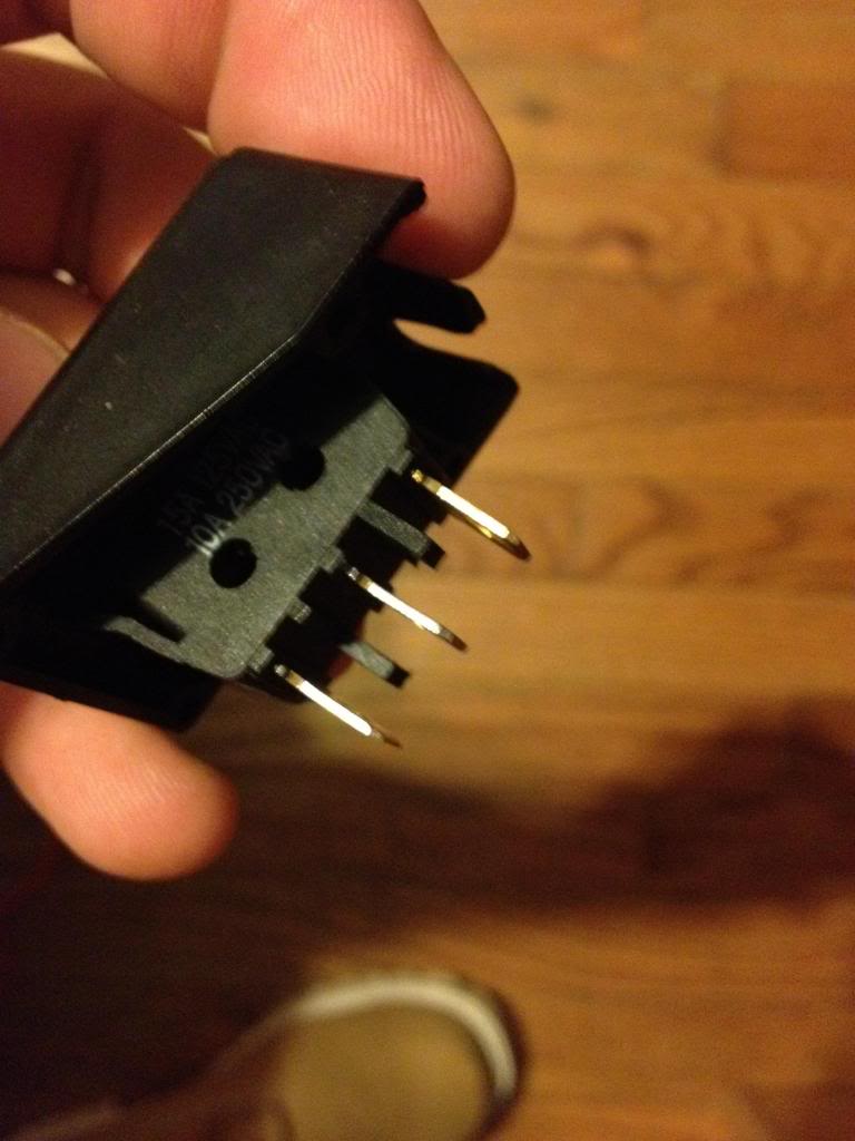

Third: Mount your interior switch whenever you would like. (Leave access, we will need to get to this in a moment). Should look like this with 2 or 3 pins.

Before running wires, here is a review on what wires go where.

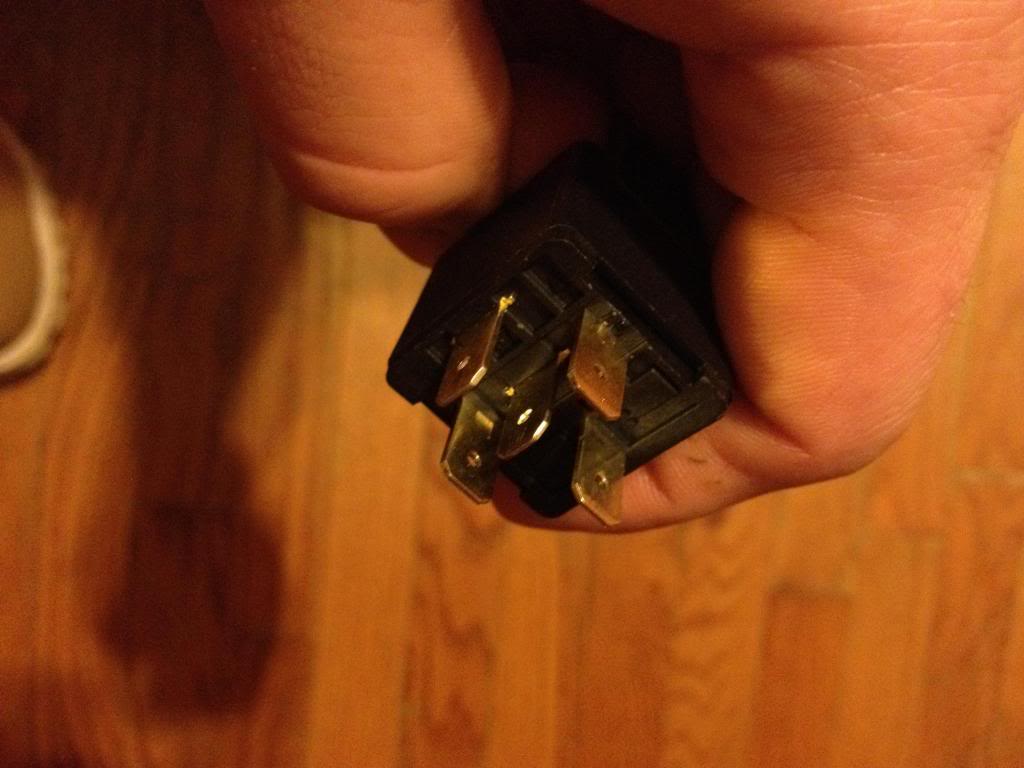

-a standard bosch-style relay will have 4 or 5 numbered leads (30, 85, 86, 87, and sometimes 87a). why they picked those numbers, I have no clue; but I can tell what they hook up to.
-30 = constant [positive (+)] power (usually wired directly to car battery)
-85 = coil ground (wired to the negative (-) battery terminal or any grounded metal panel in the car)
-86 = coil power (wired to the control source. could be a switch, or it could be the car's IGN or ACC circuit.)
-87 = switched [positive (+)] power output. (when the relay coil is powered, lead/pin 87 is connected to lead/pin 30)
-87a = [on 5 lead/pin relays only] this lead/pin is connected to lead/pin 30 when the coil is NOT powered.

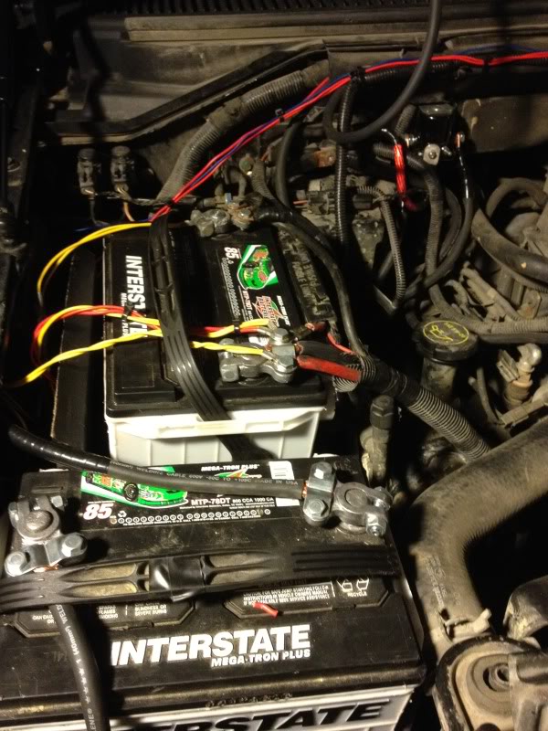

This particular part will relate to all "FUSED" wires from the battery (4), and all wires running to and from the aux switches.
1) Run two separate 14ga "30 amp fused" wires from the battery to the #30 pin on each relay.
2) Next we will run another 14ga. "30 amp FUSED" wire from the battery to the #ACC point on the external aux. switch(Once of the tow harness).
Once that is done, on the same external aux. switch run another strand of 14ga. wire from the + on the switch to #87a or#87 on the first relay.
3) Now run a strand of 14-16ga wire from the battery "5amp FUSED" to the #acc pin on the internal aux switch(one in the cab). Then, on the same internal switch run another strand of 14ga. wire from the + on the switch to pin #86 on relay number 1.

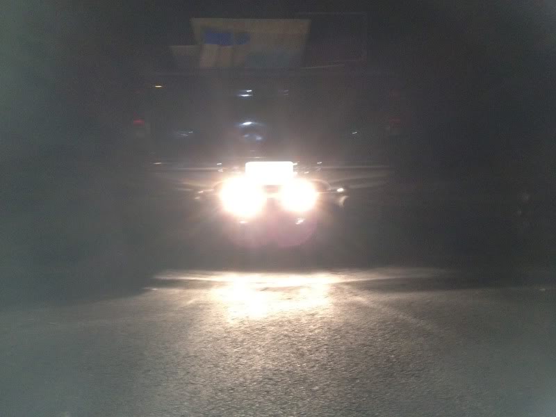

Now, replace the (-) terminal on the battery and try out your work.
Turned on without reverse.
I hid my fuses to side of the battery.

All you need is a single relay that operates off the normal reverse light circuit to ground, to cut through power from a new power lead fused at the battery.

1) Turns on in reverse
2) Switch in the cab to turn on or off
3) Switch on the towing bracket in case we are camping or loading a trailer

No, don't solder to the relay. Use the proper connectors for the relay. You solder the wires together and the connectors onto the wire, then use the correct size adhesive type heat shrink tubing (weather proof). I'm not sure if this was mentioned, but you can also use plastic dip in the pint or quart can to weather seal.

I installed a second set of backup lights, tied them into backup wires already on the truck and used the screw hole that holds the bumper to the frame-install works great there. The only problem I'm having is they only work when the ignition is ON, the engine is OFF and I put the truck in reverse. When the truck is running and I put it into reverse they turn on briefly and then shut off, therefore rendering them useless. It's not the fuse...not sure about a computer override mechanism...
