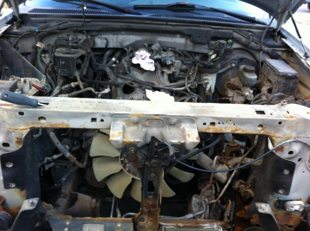

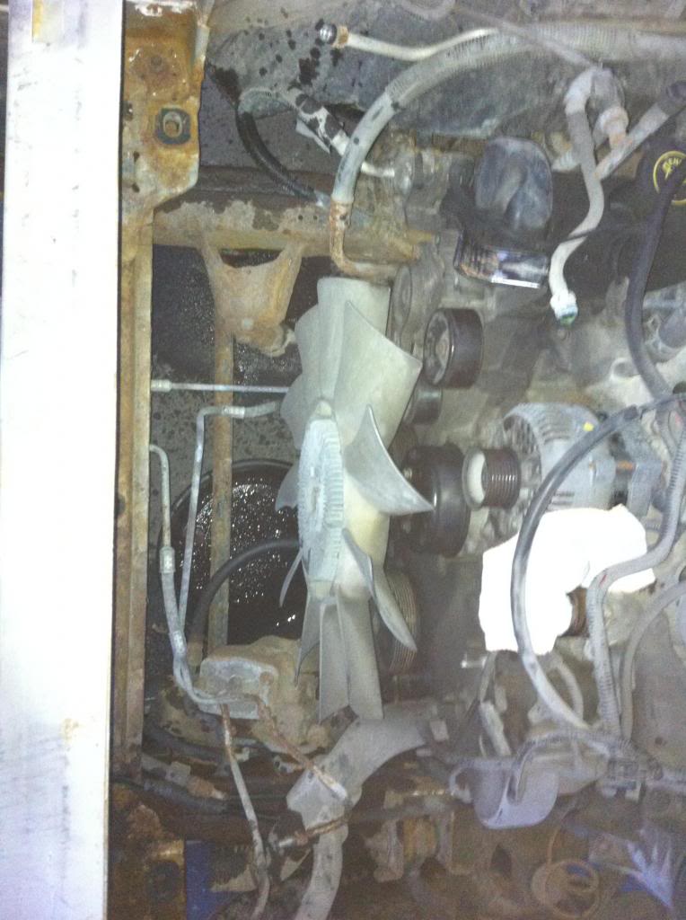

really, Lucas is no good? I put it in my 2000 2wd f150 about every other oil change. 7 years later and 160,000 kms and the motor runs great. Never ever had any problems with it and Im so happy with the performance it puts out still. Started prepping the motor for tomorrows pull and a friend and I spent a solid 1.5-2 hours tonite(wife had to work so time was cut very short) and Im happy with the progress. I believe you JMC about having to remove the intake but I dont think its entirely out of the question now. I have tons of room in there and looks to be about 12 inches that the motor can come forward but cant get the clutch fan off. I have the proper tools but it wont budge and yes I know the threads are reversed or left hand threaded.
check out the lower drivers side rad support or whats left of it haha.
Looks like I can slide the motor forward once mounts are unbolted. Im actually just going to sawzall the top of the rad support and pull straight out if I cant get the fan off :s

Place screwdriver like in image and use wrench on fan nut. You might have to reverse the location of the screwdriver because of the left hand fan nut.
Image stolen from fairlaner in this thread https://www.f150online.com/forums/ar...150-4-2-a.html

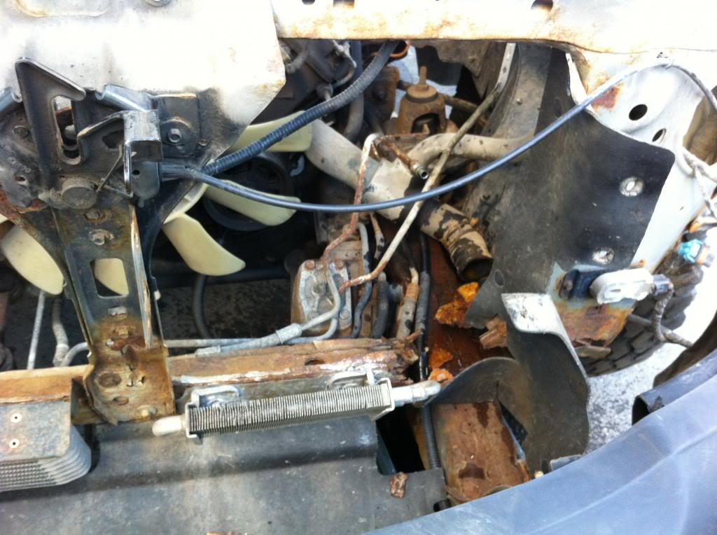

JMC, See that bolt to the left of the other sensor on the upper intake. Second sensor spot?
