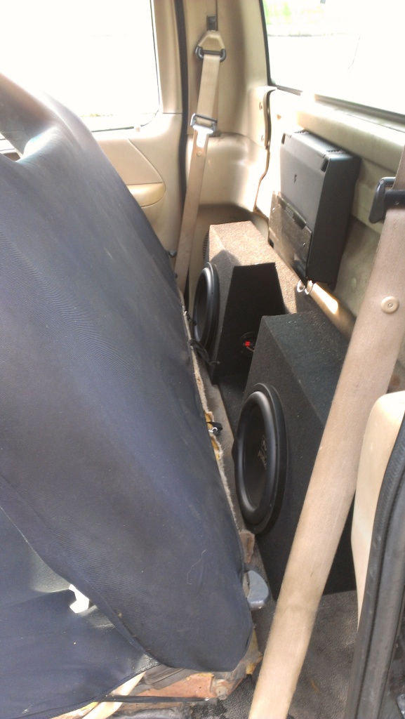

also heres what i did with the subs to give anyone whos looking for a idea and only has a standard cab.
The subs are two polk audio 10s rated at a 1000 watts a piece with a 2000watt kennwood amp. when i re due the interior im also going to be installing a capactior to help with the dimming of the head lights. also anyone running subs like mine i would realy suggest up your alt to a 135 from the 95 the 4.2s come with.

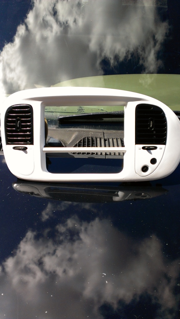

So i started this weekend with the dash here u guys go.
im gonna pull all the interior out next weekend and start offically painting it all just figured ide put up a preview.

ok so i finished the dash today and wow what a difference

First thing that popped into my head when I saw the dash was "Stormtrooper". The rest of the truck is great just not a fan of white I guess. Is that the only white on the interior?

Truck looks good man, but don't get a capacitor it's an expensive paper weight. If your havin dimming, do the big three and if it still persists I'd ditch that Kenwood amp and get something with quality in it that's a lot more efficient. imagine how much better it could sound if you could actually feed those subs 1000 watts a piece instead of the strained 500 that probably puts out around ha.
