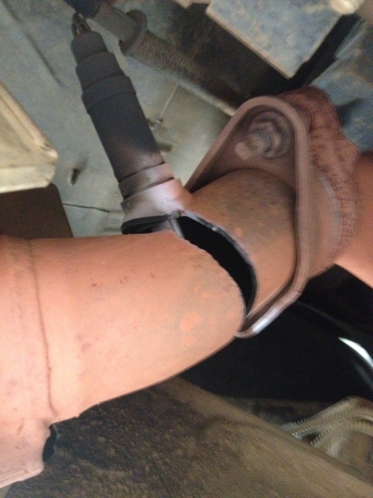

I knew I had an exhaust leak, i just didnt know it was this bad......
how the heck did this happen? I never hit anything.
Im just going to weld it shut. should I replace the o2 sensor?

I wouldn't try to weld that. That needs replaced.

Holy crap batman!!! I wouldn't waste the time welding it, you'd be better off just replacing it.

minor issue. id weld that, wrap it the best i can with another sheet of steel and weld that on to help with strength. remember its Stainless Steel.

If my meager memory is working....once upon a time, maybe read it on another forum. IDK? ANYwho, to the OP, might want to check the tranny & engine mounts or cross member. It/they maybe worn out/ broken and that is placing extra strain on the exhaust as a result.
