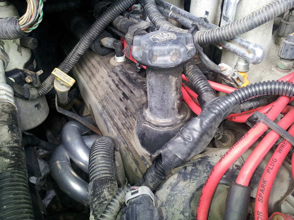

So I got it done today and I tried a product called Gunk Heavy Duty Gel . What a waste of money I followed the directions to a T and it tuned out horrible! I couldn't believe it its like I didn't do anything at all! Here are the pictures after using Gunk.

It also left a white film on everything .

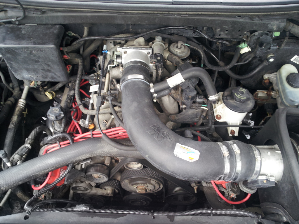

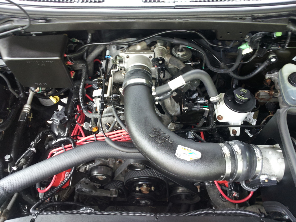

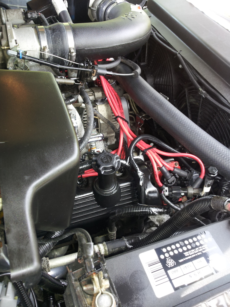

It did it over again after the engine cooled down with the super clean engine degreaser the stuff that come in purple bottle and of course came out more what I am used too. I did however use the Gunk engine shine and that did work much better than the other product. Here are the results of that .
