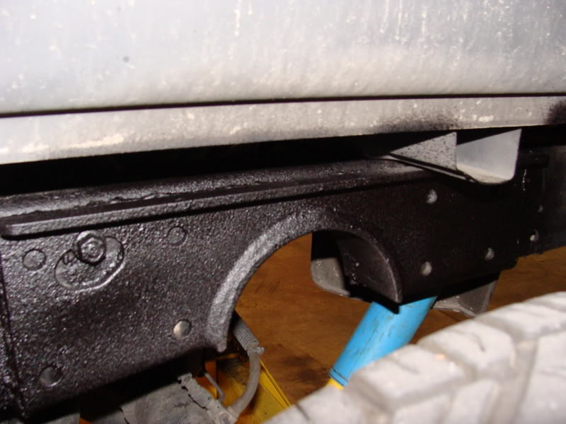

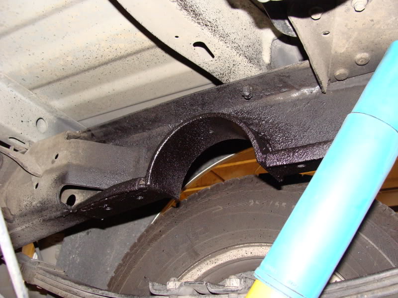

Old Aug 28, 2009 | 09:20 AM
cab and front end, the bed just mounts straight on the frame.
you can see the speed nuts here in four places
And see the bed flush mounts to the frame
