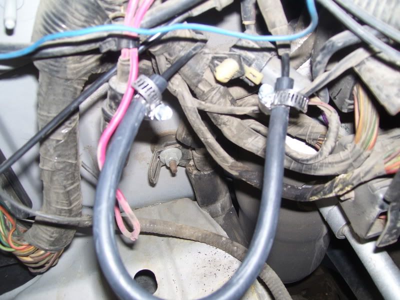

this is what i found when i pulled the battery. ;just before the T the line coming out of the dash has been burned open, the other line comes out of the T to this box mounted to the battery hold down. I will fix this leak and see what happens.

Here is the fix that I did. I used a vacuum line that sliped over the one that i cut out the bad spot. then i used hose clamps just to make sure it did not slip off. not too tight though. the under hose is kinda brittle.
checked the AC and it worked perfectly,.
