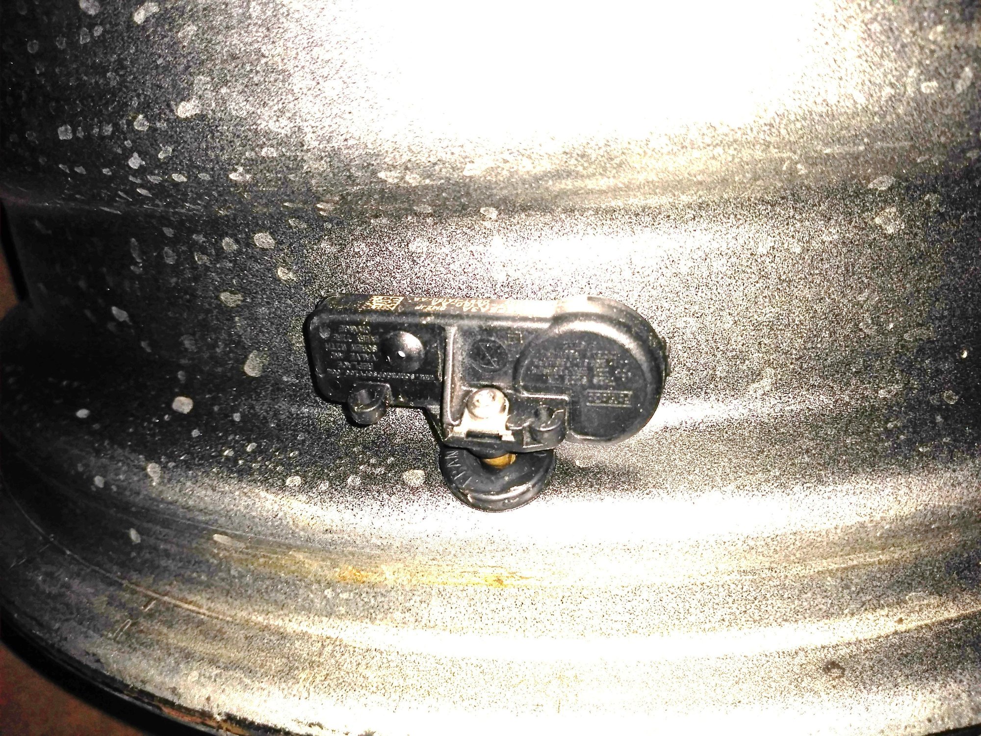

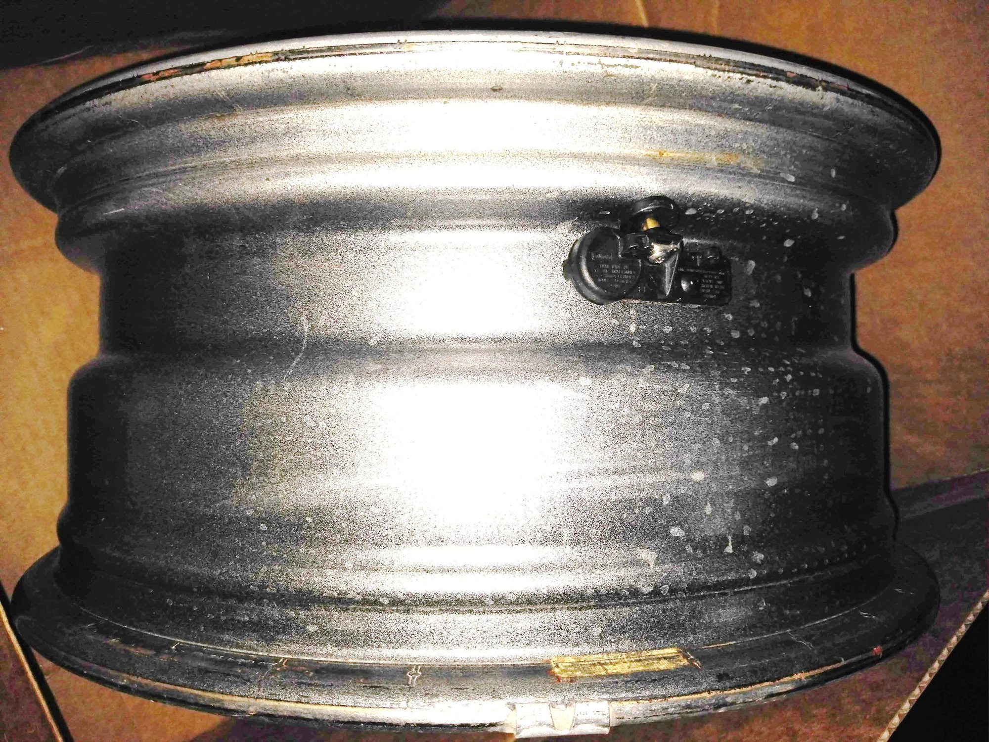

Old Oct 26, 2019 | 02:50 AM
5150_Asian_Male's Avatar
Joined: Sep 2007
Posts: 80
I just looked inside one of the wheels on my Ford. The TPMS looks like it should fit on any wheel. The current generation of TPMS mounted on a valve stem is different than when the sensor was mounted to the wheel.

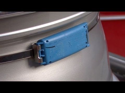

nice, yeah they're working so far, the ones I have were even smaller than the black ones in the pic, and I've never seen one banded to the wheel like that

Posts: 43,538
The first TPMS sensors were banded. They are all on the valve stem now.
