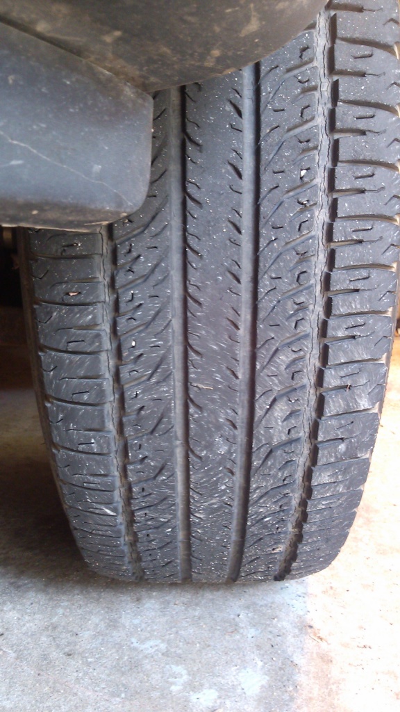

Just got my first truck, 2000 F150 Lariet.......I was planning on getting different tires for it, but after doing the coin test, I think it's a necessity.
The center if the tires are down to just at 2/32, and the tread gets progressively deeper toward the edges, to a depth of 6/32 in the tread on the edge.
This leads me to believe that new tires has become priority number one, does this sound right?

Here's a picture of my front driver side tire.....all the tires are pretty much the same

What pressure are you using on those tires? Center tread wearing more than the rest of the tire usually means over inflated. What is the tire size and load range? What is the max weight and max pressure shown on the side of the tire?
As you do travel on dirt and gravel roads, I suggest you get an LT tire, as they will stand up better than a P series tire. Unfortunately they usually are more expensive than a P series tire, but you can get some decent deals. As size and other info make a big difference in price, we will need that info.

Running at 35 psi
max pressure listed on the tires is 44psi
max weight listed on the tires is 2535 pounds
Tires are P265/70R17SL
I fiured there was an over inflation problem. got the truck 2 weeks ago and put maybe 300 miles on it. Tires were really underinflated when I got the truck....and the tire wear was pretty much what it is now...i figure it the tires were overinflated when it was being used, the went low sitting at the dealership

Is this 2wd or 4wd?
Those tires look quite dry rotted. I would replace them before winter.

Planning on replacing them before November hunting season, I noticed the dry rot too...and was thinking that was going to be an issue....still learning about stuff....when I had my sedan i didnt give a rip....owning the truck, I care about it a lot more

35 is correct for those tires or any P series with a max of 44. LT or XL P series (max 50) would be different. You should be able to find lots of tires in that size. Both P series and LT tires. A load range C LT tire will handle the dirt/gravel road better than a P series like you have, especially with the chance of flats/blowouts due to the harsh conditions. Keeping it under $150 will be the tough part.
