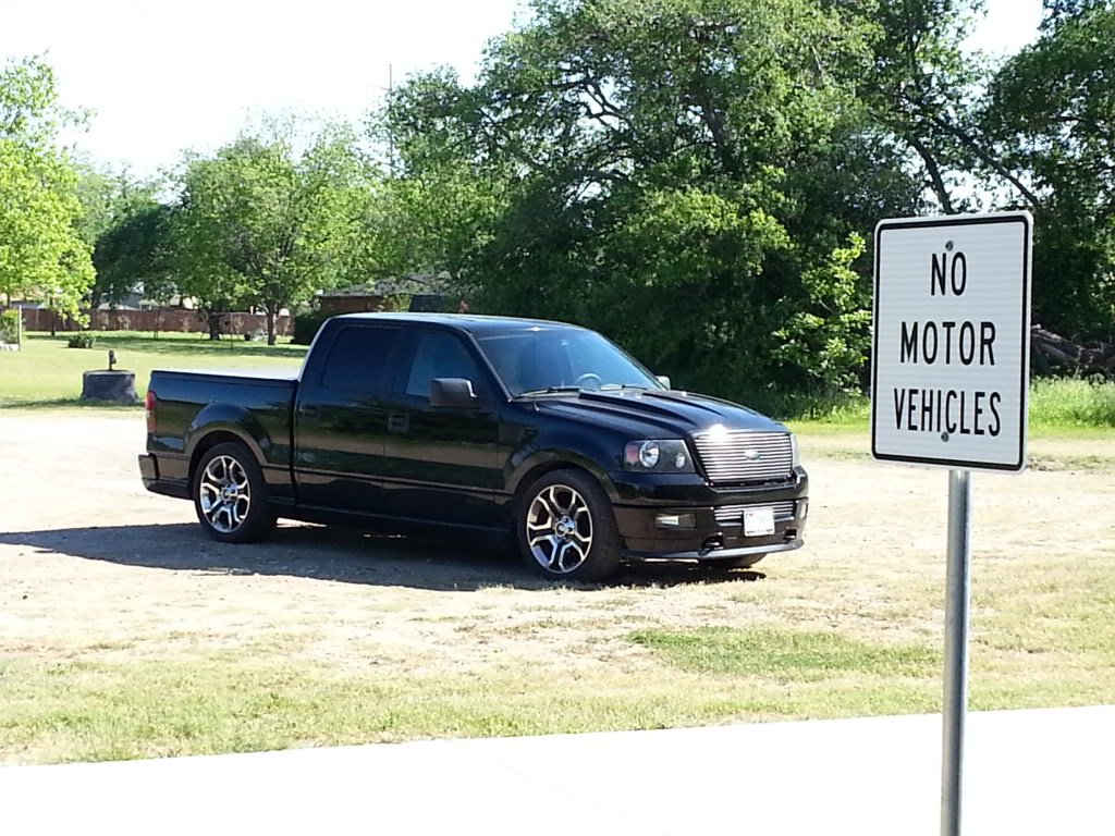

I had 265/70-17 tires on my truck when I had the rear dropped 2" with shackles. 31.6" tire, which is the same diameter (305/40-22) I run with my 2/4 drop.
Pics to give reference.

Looks good. I appreciate the pic reference. I think 265/70/17's would look good ok my truck. I have a ton of wheel well space right now.

Yes and it's a common size which makes tires a little less expensive.
