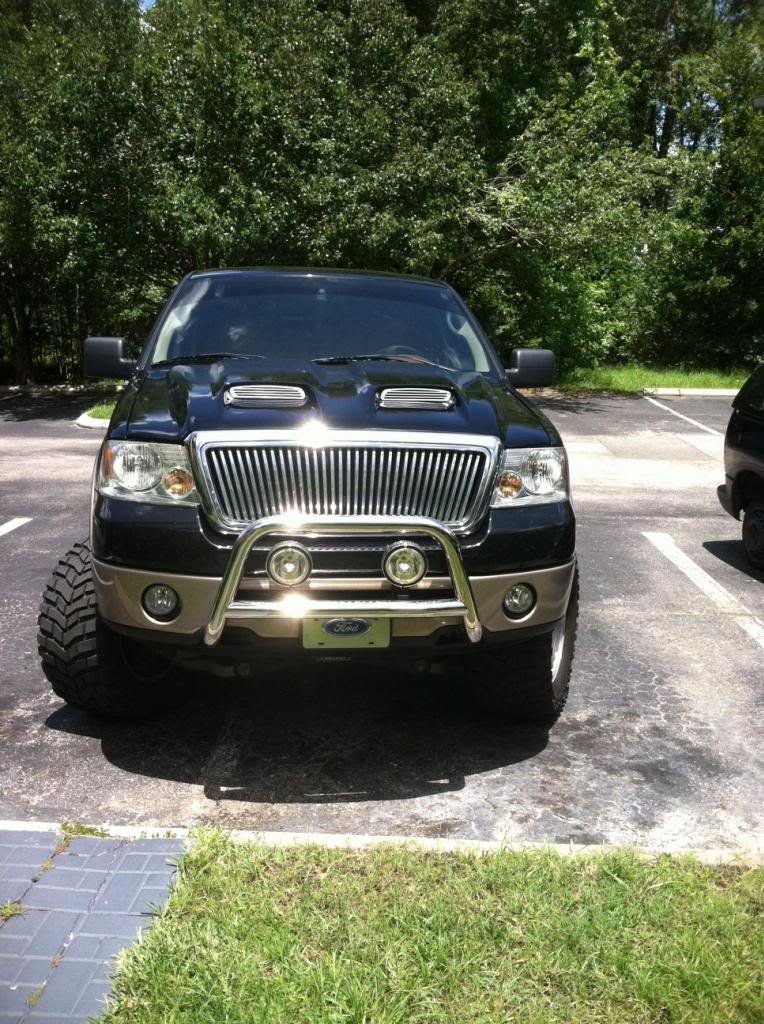

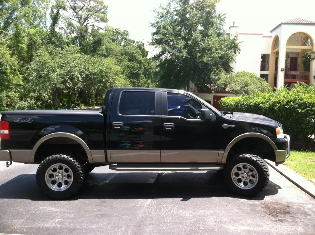

Here's the pictures for you:

Pizzaman - Thanks for posting the pictures. He has Micky Thompson rims/wheels as well. I am thinking the 13.5 will not work. UGH. Thanks so much for all of the help. Any suggestions on other brands to look at. His suggestions are BF Good, Toyo, and Super Swampers? Any thoughts on those?
Old May 2, 2013 | 03:30 PM
pizzaman711's Avatar
Joined: Aug 2009
Posts: 5,534
From: Mechanicsville, VA
What does he use the truck for? Heavy off road? Just daily driving?
The wheels are Mickey Thompson classic II's, some good news is while those are discontinued the only ones I could find were 10" and 12" wide in the 6x135 bolt pattern, meaning a 13.5" wide tire should be doable.
Otherwise if he still wants a 33x15.50 he's going to have to buy new wheels too because no one else makes them for an 18" wheel. Or he can add a bigger lift and go with a 35x15.50.
