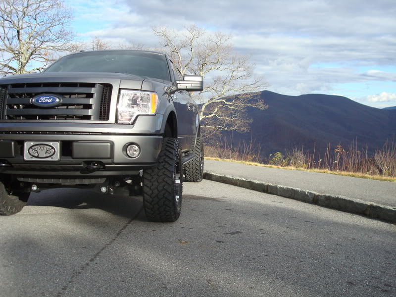

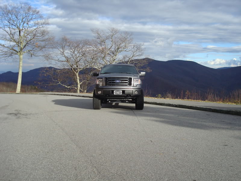

I've got 20x10 Diamo 17K with a -12mm offset and 35/12.50/20 Trail Grapplers. I had to do some trimming to keep them from rubbing and they do stick out quite a bit but I love the stance.

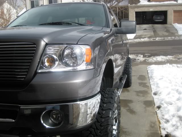

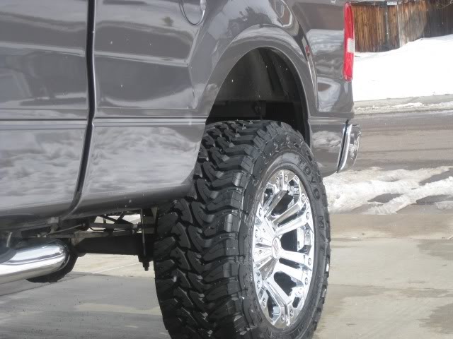

6" Lift with 35x12.50 Toyo MT with 20x10 XD monters -12 offset with no rubbing...no trimming...all good.
