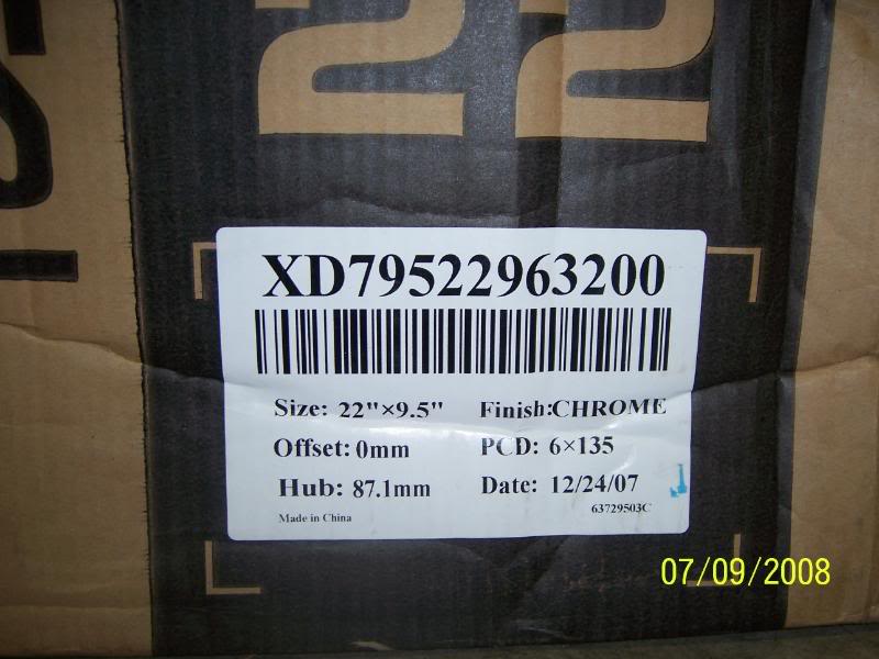

I have searched for over an hour of posts and can't find any that have the hub bore size for an 07. Dealer don't know or won't tell me. Ultra wheels I have are 87mm and company said they are hubcentric. Are they correct?

Here's the bore on my rim. They fit 04-08s

Thanks glcash. That was the answer I needed. Wheel bore 87mm.....Hub bore 87.1. Not enough difference there to warrant getting rings I dont think.
