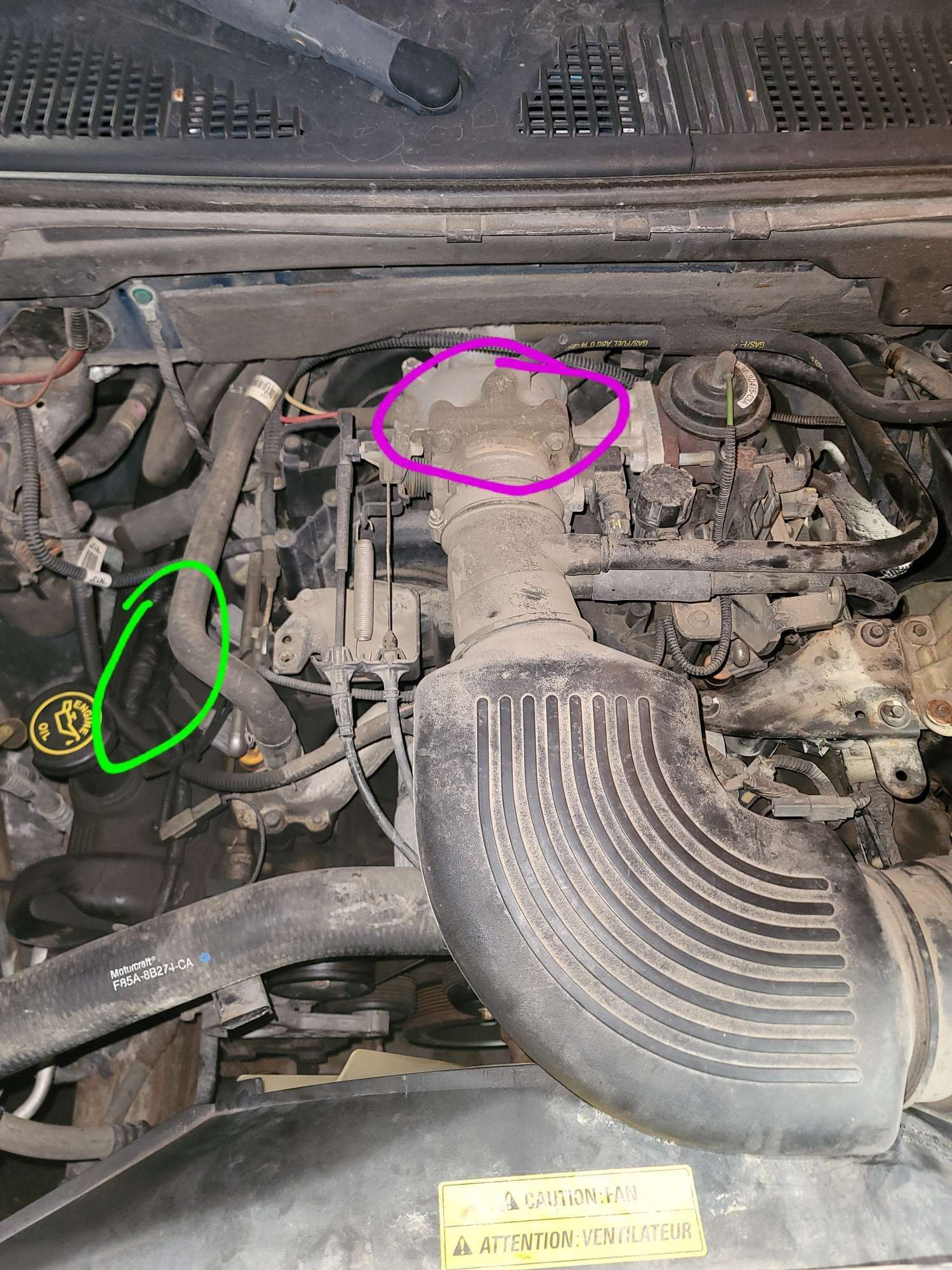

Okay I used stethoscope and prodded around everywhere. Could not pinpoint that particular sound. Could faintly hear it however the PCV valve sounds like...the only way I can describe it is it sounded like a cartoon character getting electrocuted really really loudly. That "BZZZZZZZZZTTTT" sound.

Addendums, since I've started paying closer attention
*The passenger side pcv by the oil cap. And i could only hear that sound with the stethoscope.

Originally Posted by glc
Check for vacuum leaks if it's not an accessory.
See last two replies. I'm pretty sure i hit all of the places where a vacuum would leak. I took that plastic cover off where the air intake connected to the engine (purple circle) and could barely hear it, like it was there, but a faint echo because the source is far away.
PCV (green) sounded weird, but I don't know what normal sounds like. No whining, just very
loud buzzzzzt sounds.
Old Jan 17, 2022 | 10:15 PM
Posts: 43,542
Likes: 819
I'd replace the PCV valve. It's cheap enough.
https://www.rockauto.com/en/moreinfo...t=5052&jsn=480
Don't use an aftermarket valve.
Also, follow the PCV hose back to the rear of the intake, check the elbow for rot, cracks, and leaks. If it's rotten:
