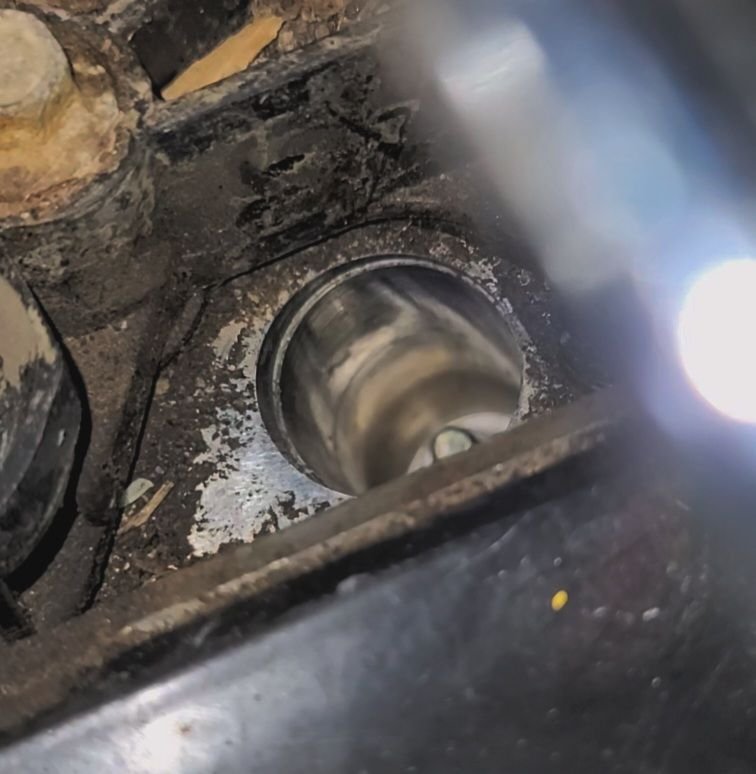

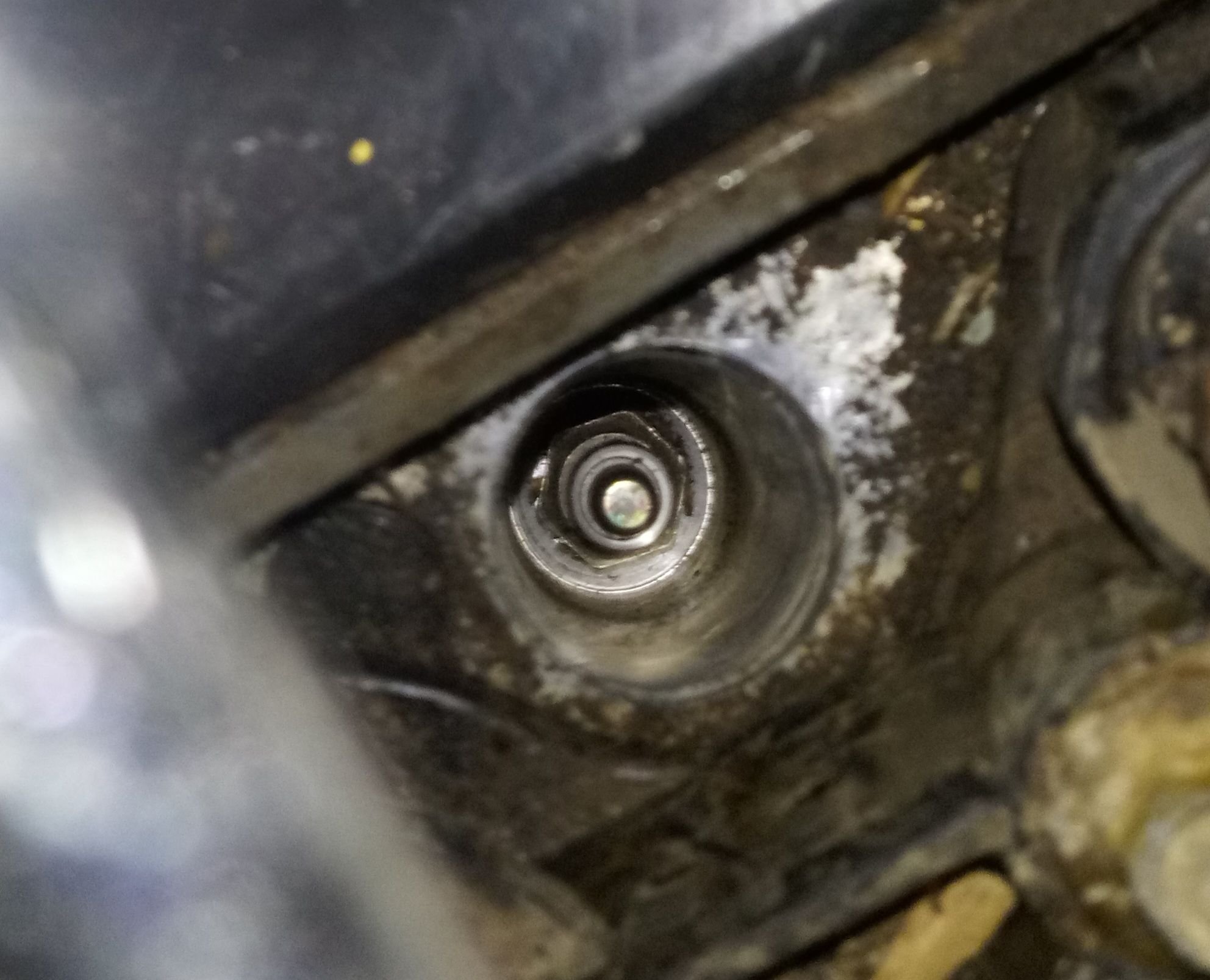

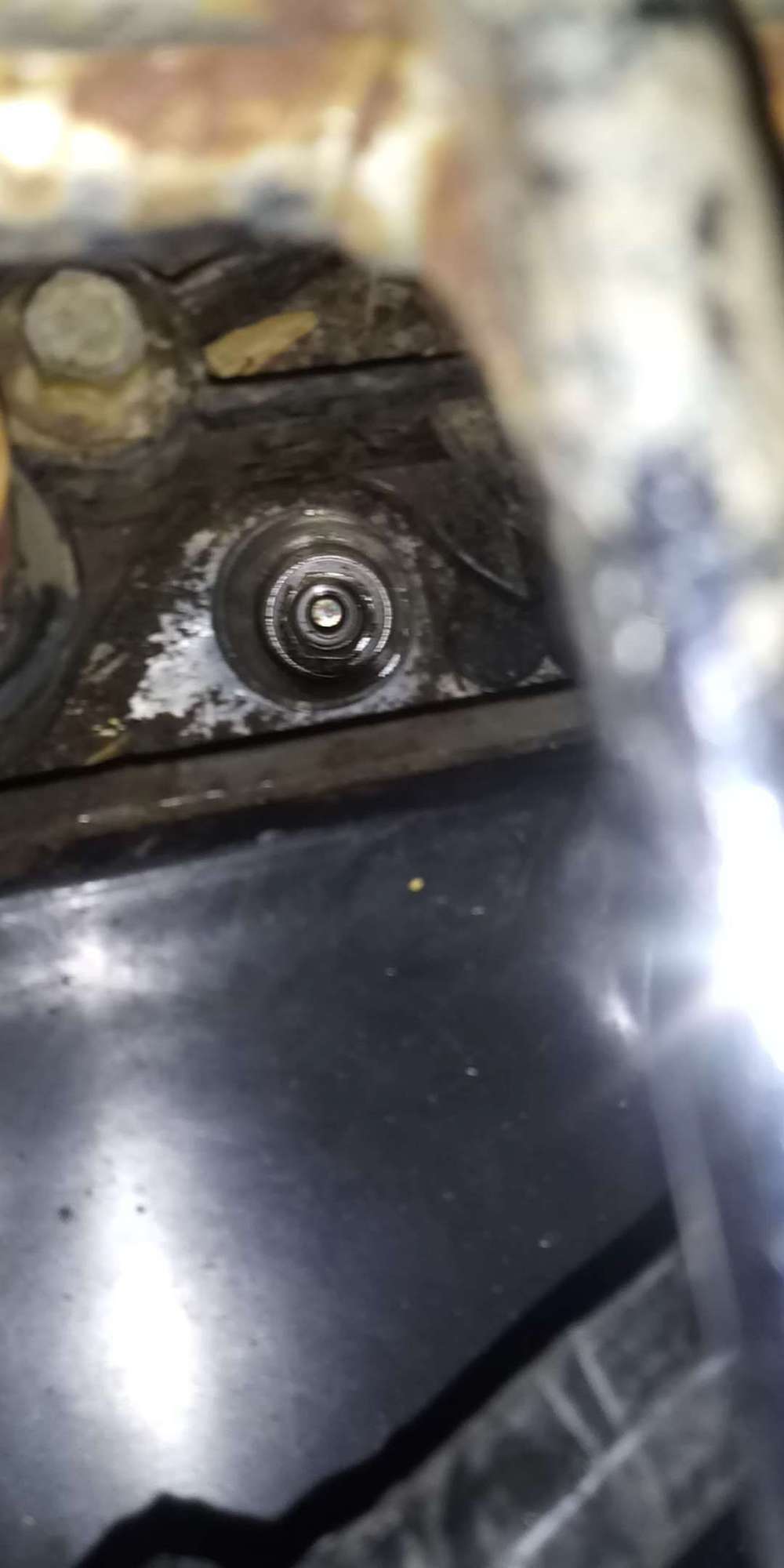

Could someone tell me what I'm seeing here?
Whistle came back.
Took the boot off. I'm not sure what's going on here, if this looks normal or is something broken?
After taking this vid, i tried both tightening and loosening it. It's in there tight and doesn't appear to be backing out.

Maybe I'm just tripping and the angle and lack of depth perception it's throwing me off.

If it whistles with the plug tight, replace the coil.

I suggest replacing the plug just in case also.
