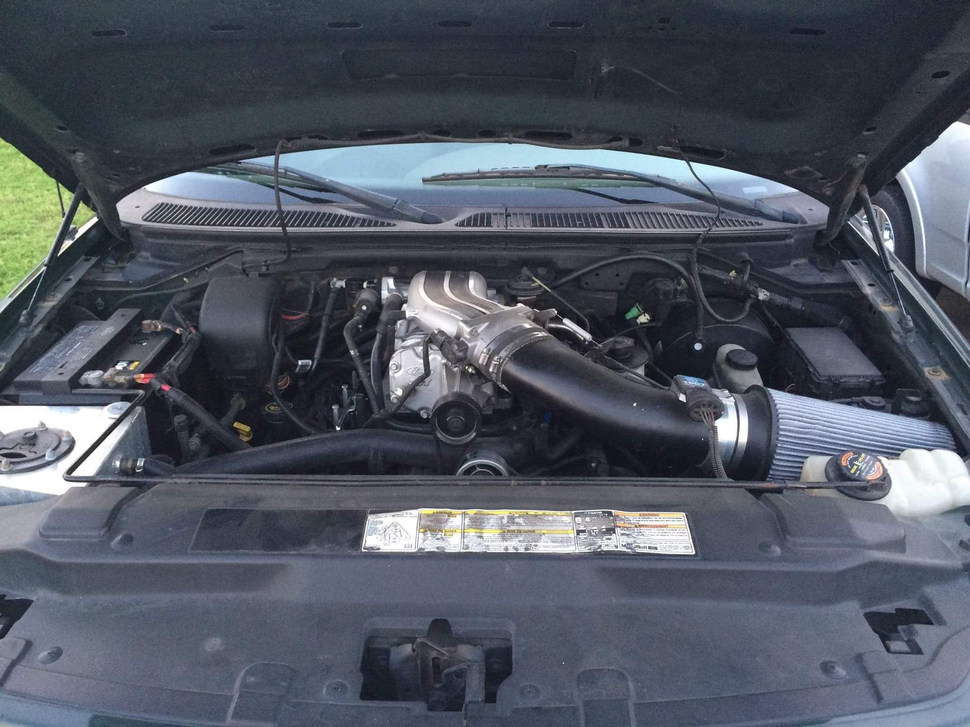

Originally Posted by PapasTruck
Ive always heard those are a waste of money
centrufigals can be a lot of fun...
my green truck out torqued the KB 2.2 trucks when it was procharged...
I do miss the procharger as it was faster, BUT the heaton is fun
8805 12568 210575
