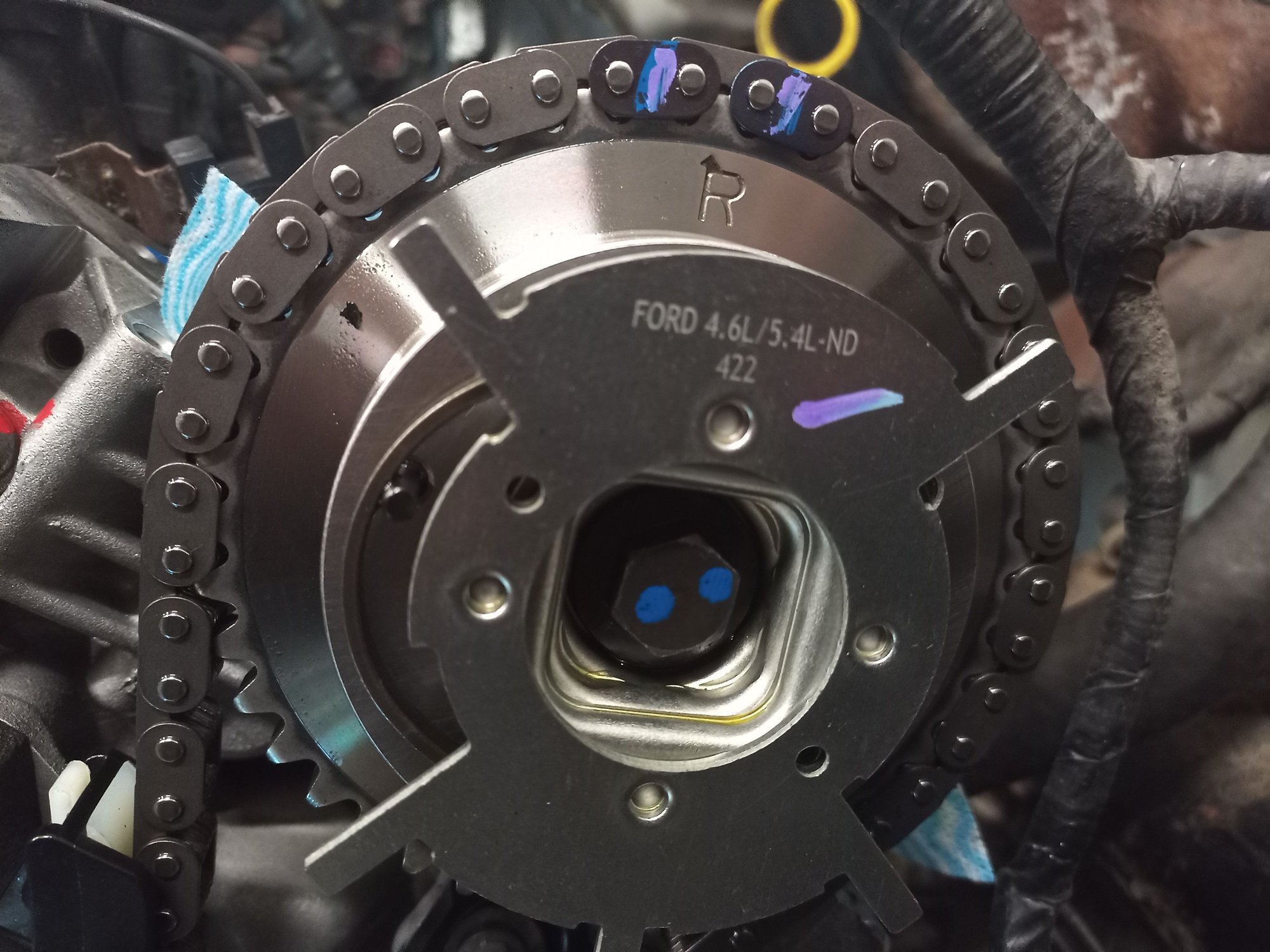

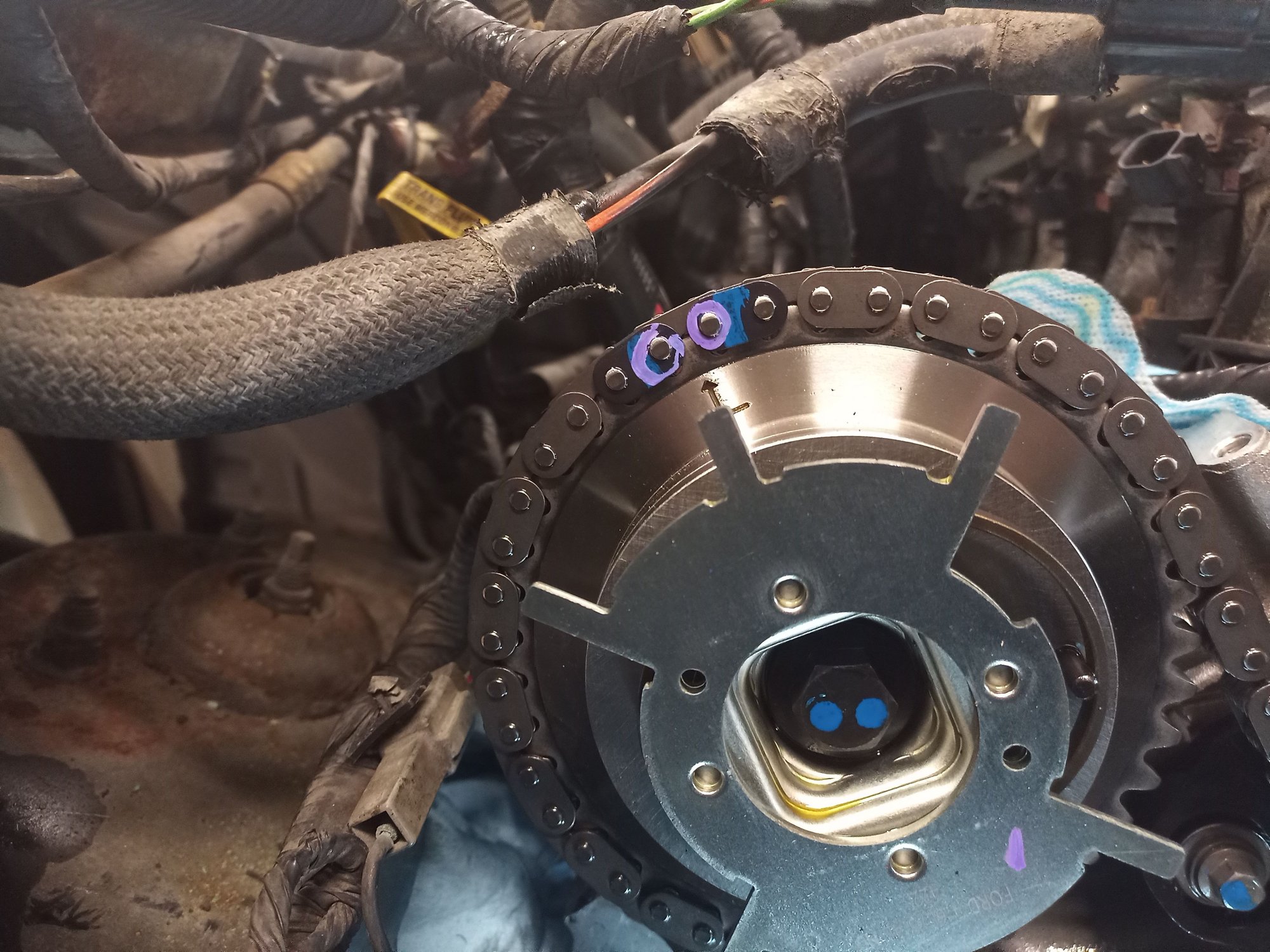

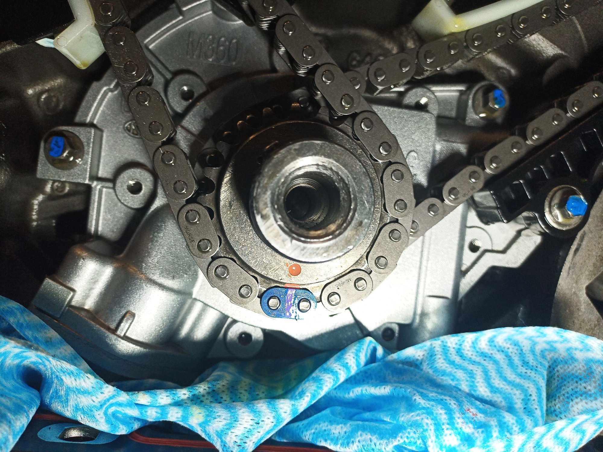

Supplier indicated that I must have knocked timing out by rotating engine backwards. I don't recall doing that, but I took their word for it. The timing was indeed off. I re-timed and took these photos of the timing marks. Started it up after reassembly and still running rough and leaving codes P0012, P0016, and P2196.

Your phasers are swapped. Left is driver's side. That could throw the timing marks off. Watch this:

I believe it is 180 degrees off, but my understanding is that this should not make a difference.

So, you think that there is no reason the phasers are marked right and left? Surely you jest.

Retired. Pics attached. Still getting p0012, p0016, and p2186 after this reset. Runs rough. Not sure what I fouled this time around.

Make sure the codes are deleted and see if they come back. At this point, I think I would be suspicious of the cam sensor or wiring to the sensor. The manufacturer may have used cheap aftermarket sensors.
