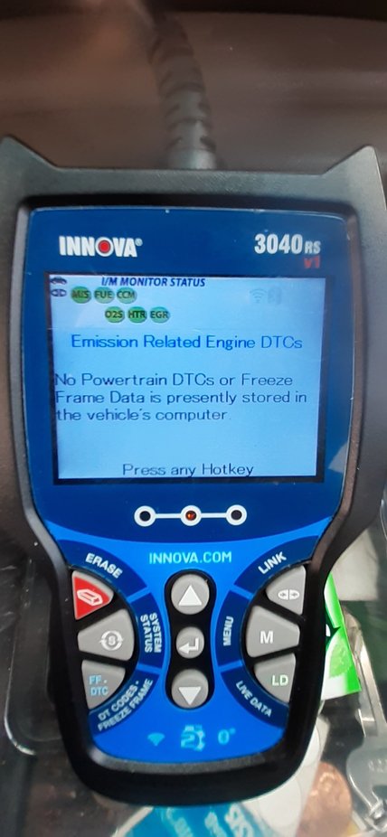

I've rechecked for vacuum leaks, cleaned the MAF, and everything on the truck checks & tests out fine (no codes).

I also purchased an Innova 3040rs with 'FixAssist'- To be honest I'm a novice with this tool. I'm not even sure how to access mode 6(?) but I'll try to attach photos with useful Info(?)

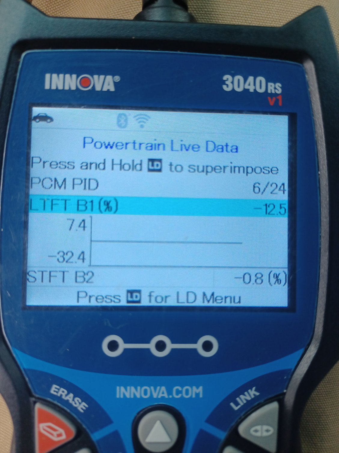

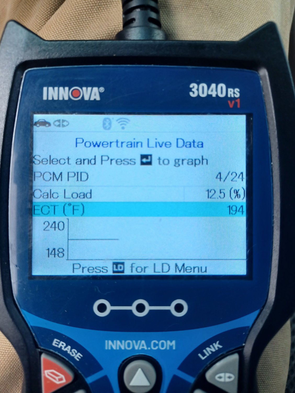

Fuel trims
STFT B1 fluctuates between 3.1% and -3.9%
LTFT B1 0.0 %
STFT B2 fluctuates between -10.9% and -6.3%
LTFT B2 0.0%
ENGINE RPM 725
Spark advance between 16.0 and 25
IAT 81f
Maf 1.16 lb/min
TPS 19.2%

Old Jul 3, 2021 | 11:15 PM
Posts: 43,526
Those seem to look okay to me, nothing extreme and reasonably even between banks.
