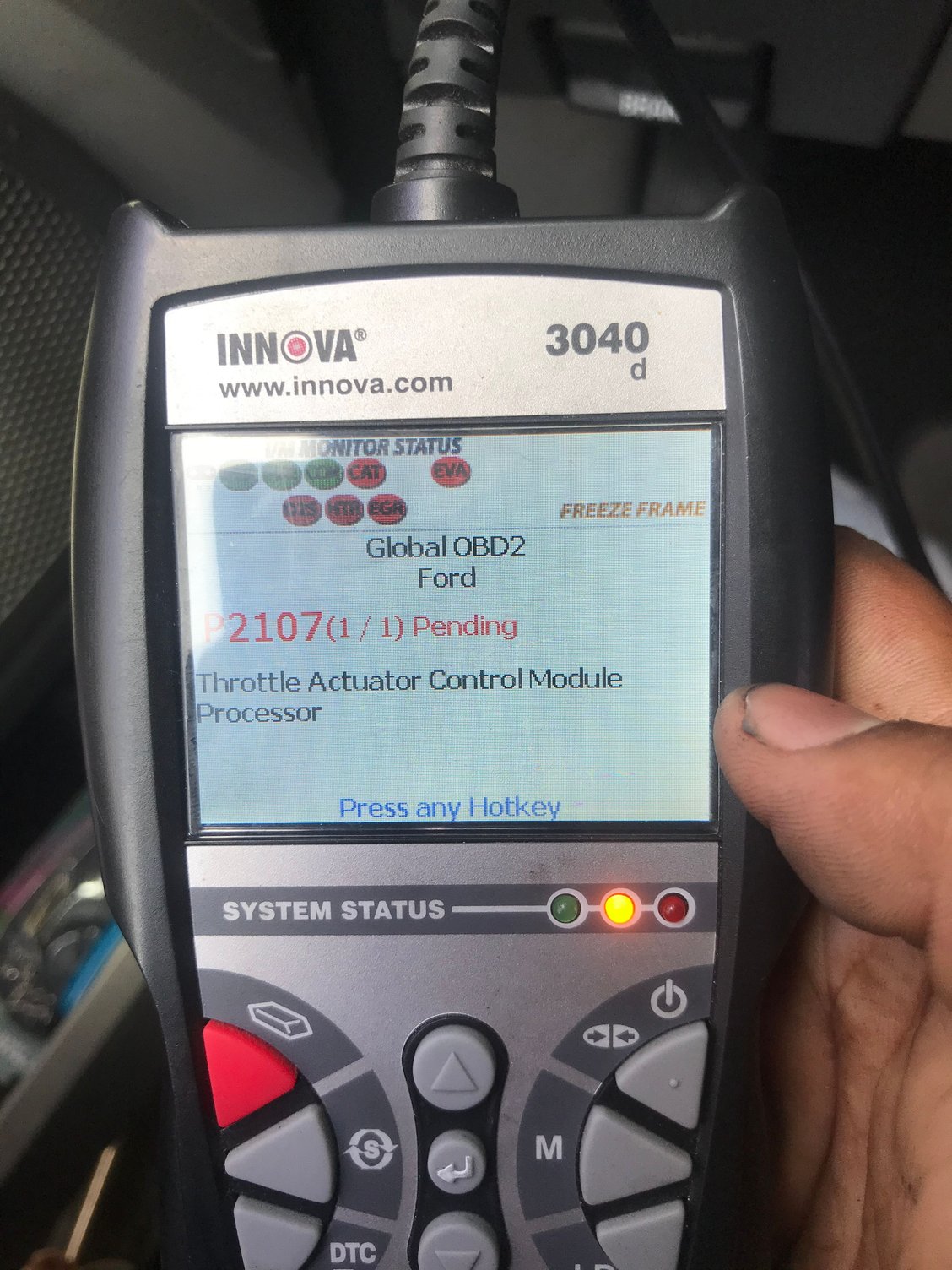

I was driving my truck one day when it died while stopping at a roundabout. Before this day it wasn’t shifting past 2nd gear. Initially I thought it was the alternator as I had to have it recently rebuilt and figured the guy did a bad job, therefore I changed it along with the battery and belt. Nothing. Originally I couldn’t scan anything because it seems as my PCM was burnt out of which I replaced then I scanned the truck and Throttle Body codes came up (about 8) so I cleaned it out and tried again, nothing. Changed the TPS, nothing. Frustrated now, I then changed the entire throttle body, STILL NOTHING.
I scanned again and a new code shows up, CamShaft Position Senor, changed it out without anything changing. I check the plugs as the codes say the Throttle Body is stuck open/idle/limited RPM and basically putting the engine in Limp Mode.
When I attempt to start the engine, it starts for two or three second then cuts out and doesn’t rev when I press the gas pedal. I admit I had a temporary battery that was not up to the amperage that I assume burnt things out. The fuel pump seems fine and doesn’t throw a code. I’ve reset the brand new PCM and also deleted the codes via scanner; only one code P2107 shows up after until I try to start it. I disconnected the Throttle Body and Cam Sensor and it shows three codes.. related to Throttle/Pedal Position Sensor B.. could this be a simple relay or fuse problem?
I have no idea where to go from here.. please help.

So as I promised, I tried it and took out the plug and checked it. I then took out the air filter and my truck started to run and didn’t turn off until I turnt it off to try delete the codes. However after I did that, it went back to what it was doing.
I used the live data feature on my scanner (I don’t know why I didn’t think of this before) and depressed the acceleration pedal and the percentages went up accordingly, so I think it’s safe to say that works. It still will not allow me to rev and the P2107 is still the most consistant code.
