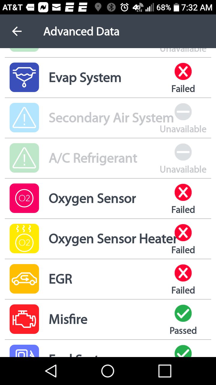

Then when I do a mission check it says something went wrong with egr and evap syatem
Can you be more specific with details?
Old Feb 11, 2020 | 10:56 PM
Txmike's Avatar
Joined: Feb 2020
Posts: 9
This is what pops up.
Old Feb 11, 2020 | 11:41 PM
Posts: 43,535
Those should be throwing numeric codes........
