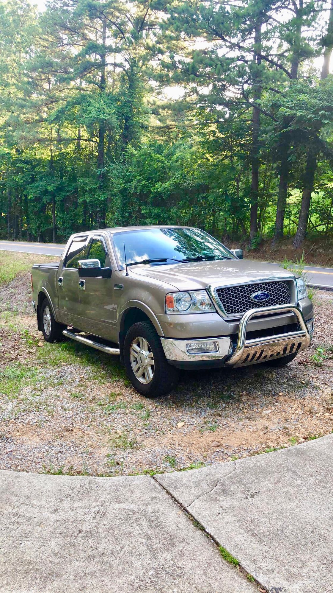

So my oil pump went out and the timing chain in my stock 5.4 broke. Getting a new jasper motor ordered. I want to upgrade my cam. Not looking for anything crazy, just a moderate cam that will up the power but still keep it simple and reliable. Any recommendations on what cam to go with? As well what upgrades need to go along with the new cam?
Clean 2 owner truck with 120k miles. Leveled on 33s
