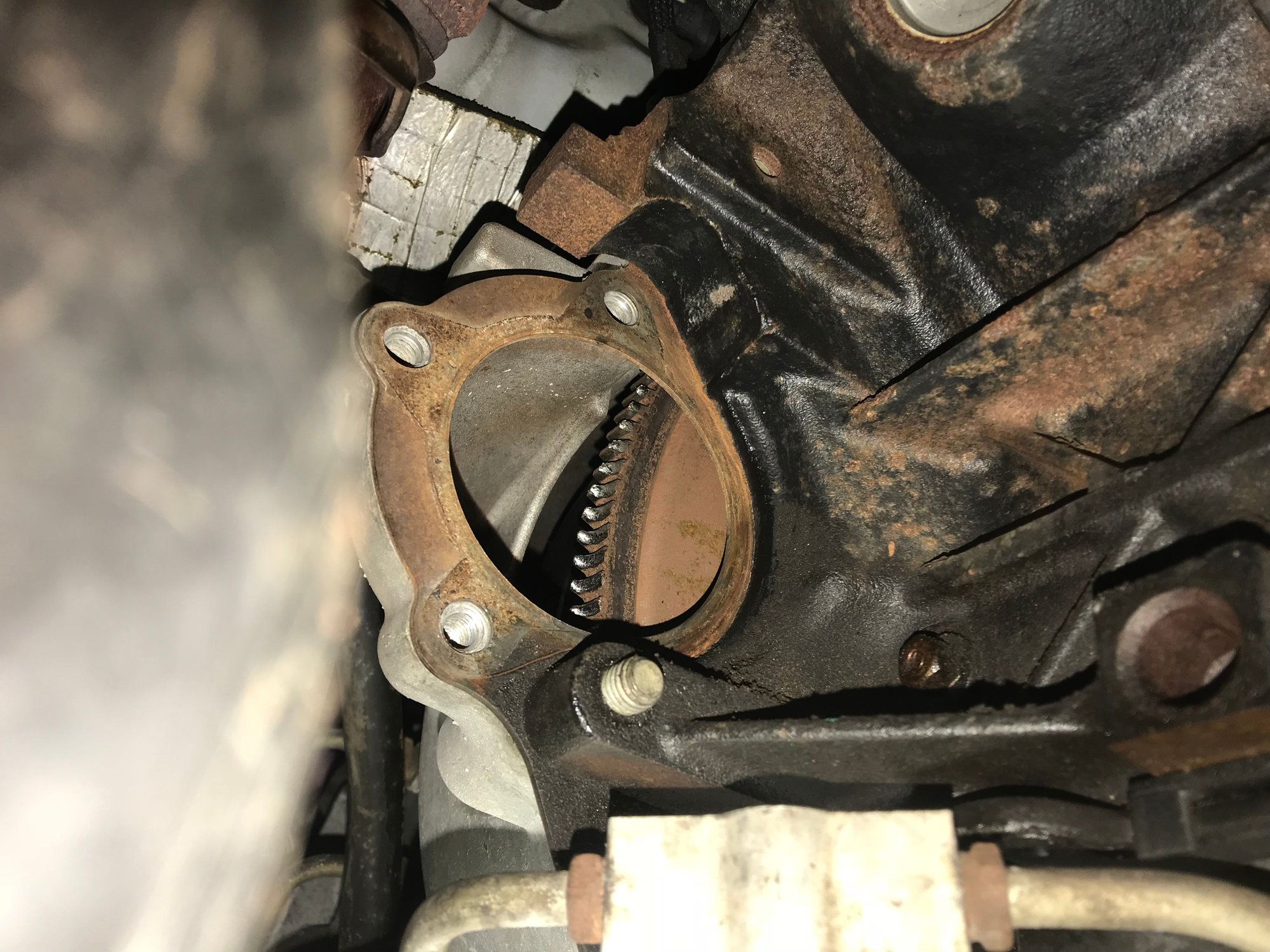

A couple years ago I did the timing set on my truck. While I was in there I replaced the starter, just as a preventative. The new starter would not always engage. I would have to “bump” the ignition to get it to engage. I replaced that starter and still have the same problem. I then replaced the cable harness that runs from the starter to the battery. Still had the problems. Then I replaced the ignition switch. Still have the problem. Next thing for me to check is the flywheel teeth. After that, I don’t know what else to replace.

Don’t know how I missed this but I did! Thanks to everyone who contributed constructive criticism and or advice. Ford flywheels suck. Well, mine did. Oh and I also noticed my pinion seal is leaking , again. Yes, it was replaced a few years ago. Cheaply made parts are not making your loyal customer happy Ford Motor Company!

Long story short, we had an old Ford E-350 at work that had missing flywheel teeth.
