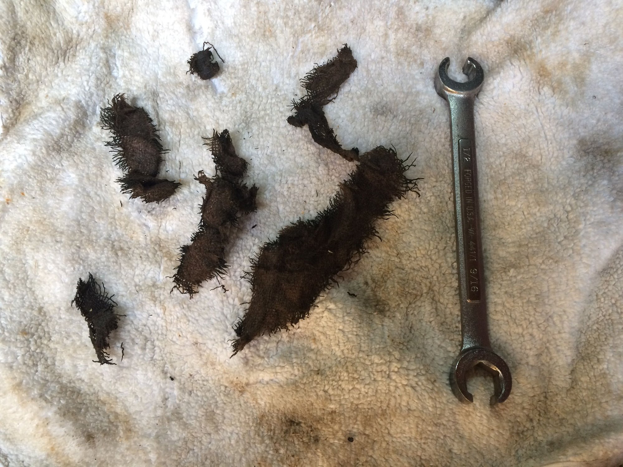

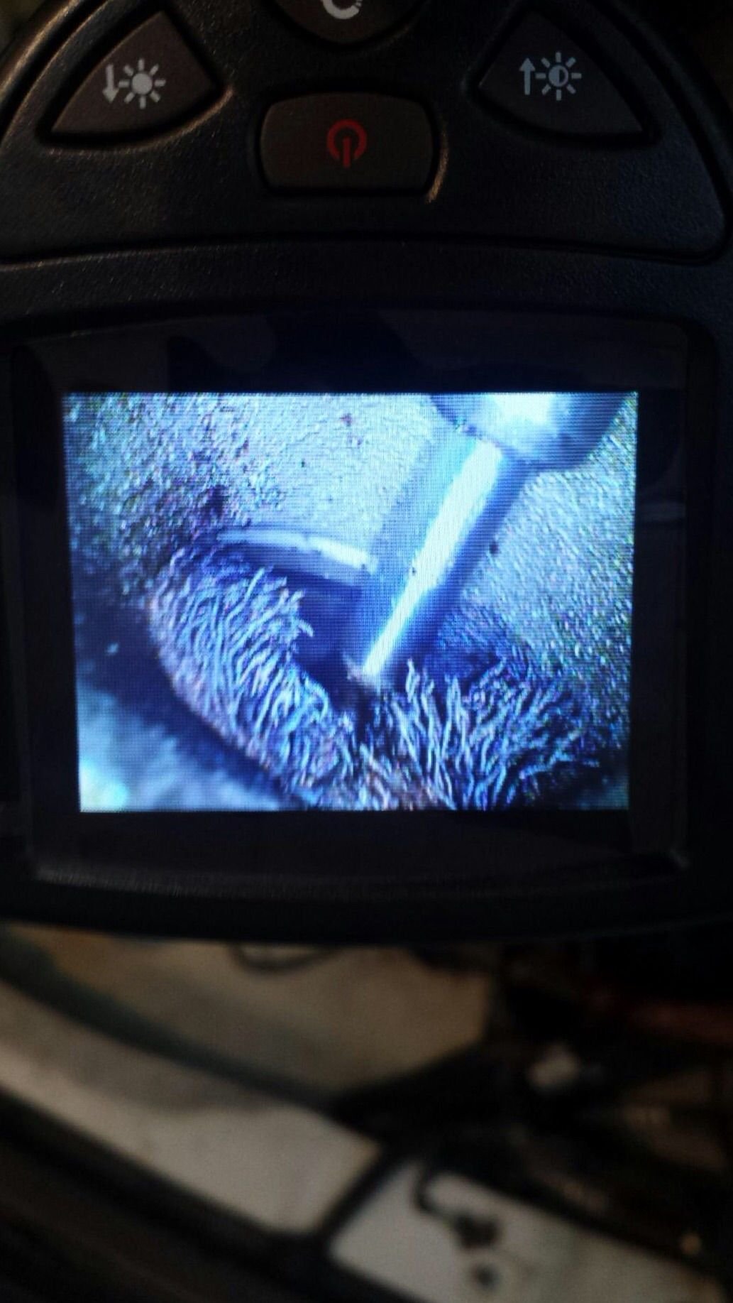

So this was an interesting discovery. Valve wasn't bent it had a piece of rag stuck on it! Guess it couldn't fully seat and allowed the follower to fall off.
