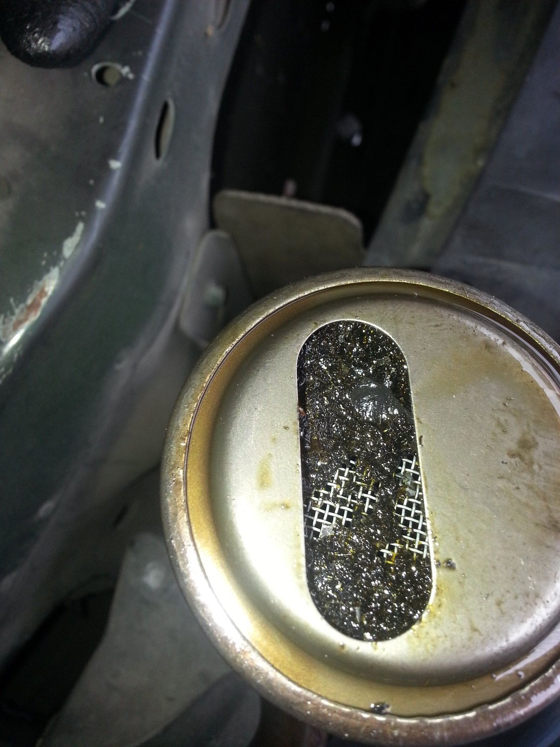

It was the sump screen. I don't think the block was completely clean and I use motorcraft filters. Engine probably has less than 1000 miles on it since installation

There were iron flakes, and some other non-ferrous particles in the mix. There was also a small piece of plastic that must have broken off the timing chain guide and migrated to the pan.
I have drawn the conclusion/assumption that the new shop did not hot tank the block like I requested. However, the block was cleaner when I received it but I did have to buff out some rust on the water pump ports but I didn’t think anything of it. They must have just steam cleaned it.

So the black material in the sump screen was plastic from the timing chain guide, the non-magnetic material was from the timing cover, and the magnetic material was from the 8mm bolt in the pic that was ground down by the chain. Thus ending the economy parts venture
