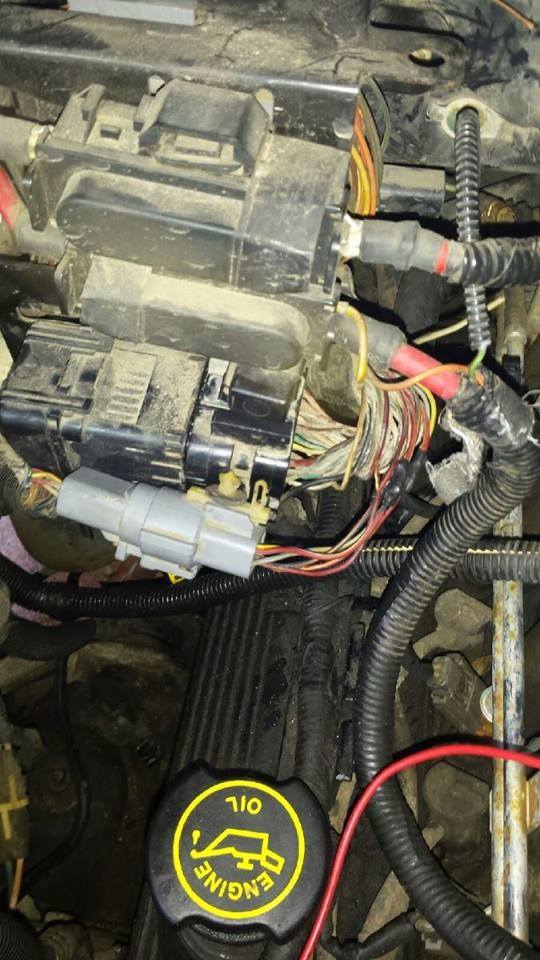

Ok so I found what I believe to be the source of the problem. it looks as if someone cut the wiring harness and did a redneck patch job. there is a disconnected wire that has no home, it is a gray with yellow stripe (might be white stripe) nothing in the immediate area is disconnected and there isn't room for anymore pins in the connector
I looked over the wiring diagrams on chiltons online but I could not locate it.
thanks again for the help

I did download the manual, it helped tremendously in finding the location of the connector. I browsed through the downloaded manual and the Chilton's manual and I cant seem to locate the wire that has been cut.
