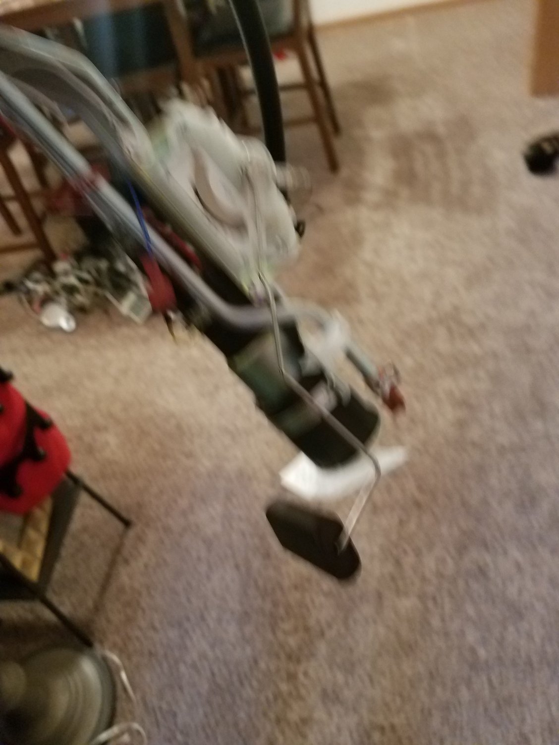

this is the pump i put in 2000 f150

The difference is the whole thing like pictured or just a generic jet pump that you have to clamp in place in the assy. I have not had much luck with the aftermarket brands and stick to OE on fuel pumps. Here is what i found.
