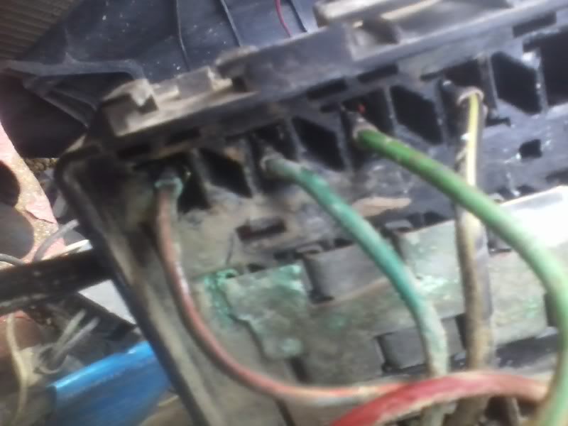

I noticed my sub woofer stopped working so i went to the main feed line were it draws power *Primary 12 volt feed to fuse box under hood is where it is hooked* so i poped the fuse box only to find SOLID green EVERYWHERE!
Here are pics of the under side.
That black wire with an orange tracer any guesses what thats for? if you guess fuel pump you are right!!! many other pins look like that or worse!
Also my coil packs have come loose and in trying to fix them 3 bolts on each side broke. so only having 1 bolt holding on each coil pack is not giving them a good ground. making it run like crap as well.
Question 1. Do they sell this direct fit fuse box for my truck?
Question 2. do they sell the coil pack brackets?
Question 3. if after 2,000RPM my truck lean pops why when i let off the gas does it shoot a flame out the right pipe?
Thanks all! could really use a big hand on this one.

well somthing fun happend last night. i turned on my E-fan and all my gauges normaly just turn back to blue. but last night they stayed there normal color. after about 5-10 seconds they faded to this very dim red color. and my e-fan doesnt work any more....
my Gauges pull power off the coil pack fuse. my E-fan has a wire direct from the battery with an inline fuse *Have not check the fuse yet but im 100% sure its blown*
my question is why if these 2 pull power off very diff spots does the E-fan effect the color of the gauges?
