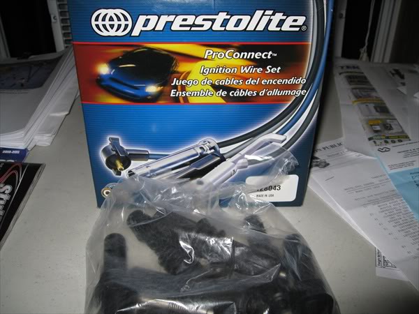

Bad Wires??? what wires?
I would venture a guess that this is what the "wires" are :
Those are the Boot and springs from Rockauto
