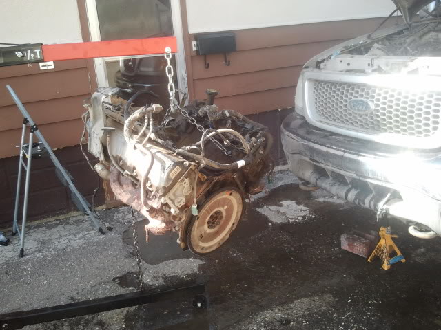

I recently bought a 99' F150 with a blown motor. The motor had some pretty heavy knocking, I suspected it was rod bearings and upon pulling the oil pan confirmed my suspicions. #7 bearing had spun and scored the crankshaft pretty bad.

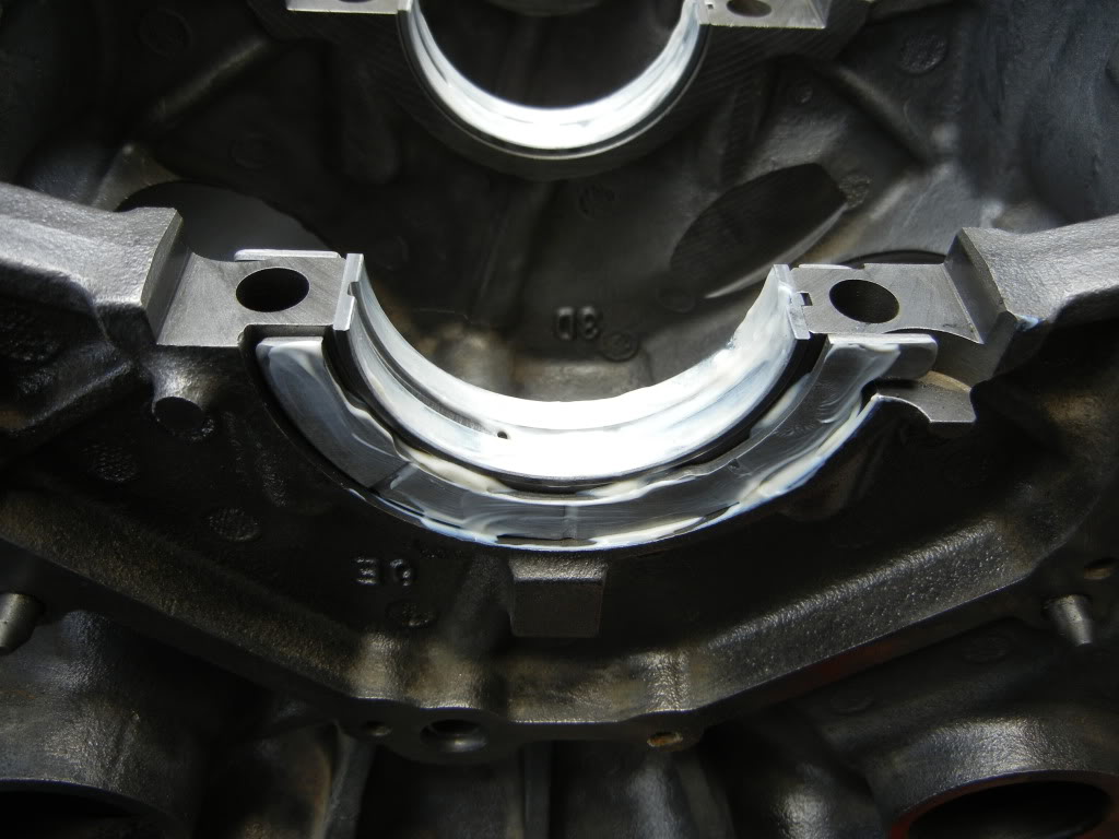

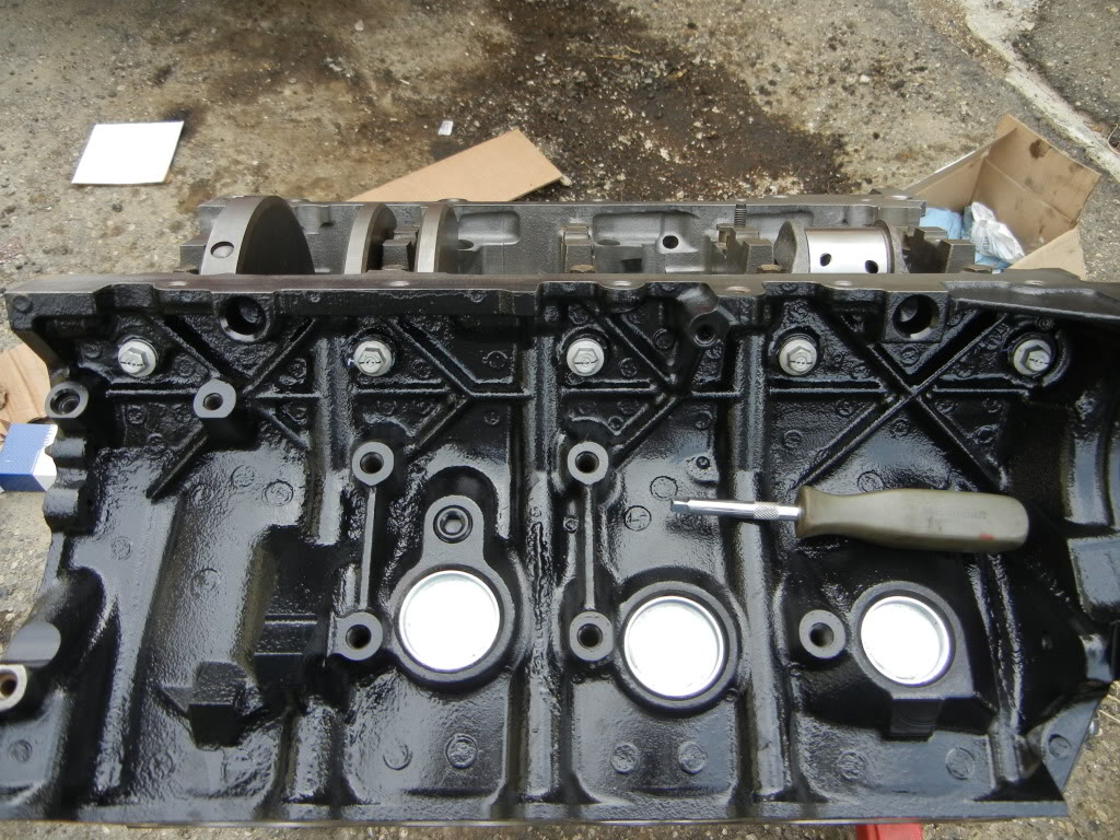

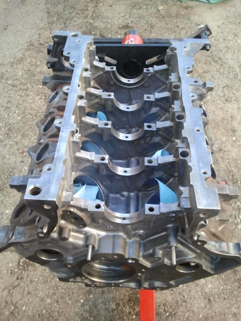

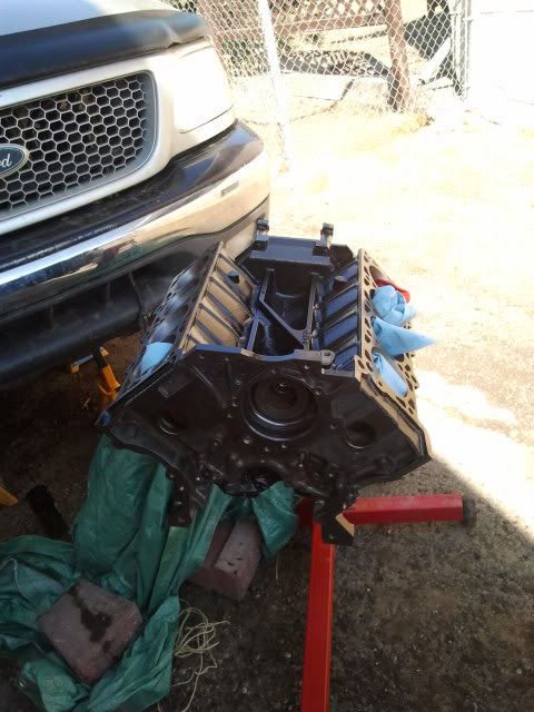

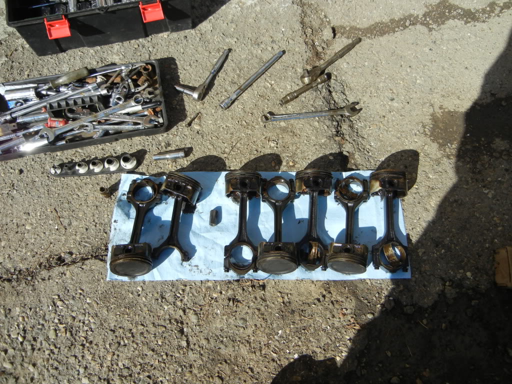

Started rebuilding the 5.4. The pistons are in really rough shape in terms of carbon / sludge buildup. I have soaked and scrubbed them in varsol repeatedly but still can't get them to shine. Rather than spending 20 hours cleaning landings and risking the possibility of scoring the aluminum pistons, I opted to go with a set of NPR pistons that include rings. However, I had originally bought a set of Sealed Power (Federal Mogul) rings that I was planning on using.
I have heard mixed reviews about NPR piston rings / oil blow by. I was thinking of using the sealed power ring set on the NPR pistons, but am unsure if I should just use the rings supplied with the pistons instead. Thoughts?
So far the heads needed 2 intake valves and a fresh set of lifters (pretty sure the other ones have pieces of rod bearings in them). They have been port and polished, planed, and had a valve grind done
Heres a few pictures so far.
Note the chunks of rod bearing in the oil passages... New crank!
Years of leaking valve cover =
Block after hot tanking, hone, and some paint

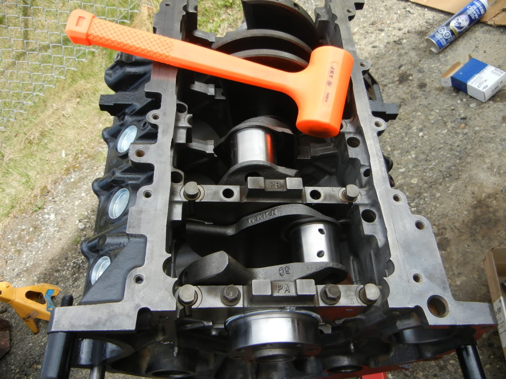

Dug into the transmission while I was waiting for parts. Steels and fricition plates appear to be in really good shape aside from some minor heat spots on the steels.
Installed the new crank with thrust and main bearings today. Didn't have a torque angle gauge so I torqued the bolts to spec and then sharpied a line on the bolt so I could visually confirm I got the 90 degree rotation after torquing (dowel to main cap retaining bolts are torque to yield and must be replaced once used) Used lubriplate as assembly lube to hold thrust bearings in place and on surfaces of new bearings. Got pretty much all the replacement parts I need to do this motor. Just waiting for pistons now!
Old May 16, 2012 | 12:12 AM
Toyz's Avatar
Posts: 3,291
From: Beaverton Or.
Are those thrust washers backward or are the grooves supposed to face outward.
Old May 16, 2012 | 02:24 PM
shoon's Avatar
Joined: Mar 2012
Posts: 60
From: Dawson Creek, BC
Grooves are supposed to face outwards for oil flow between crankshaft surfaces and thrust bearing.
Old May 16, 2012 | 07:27 PM
DYNOTECH's Avatar
Joined: Oct 2006
Posts: 1,770
From: Michigan
Thats correct.
