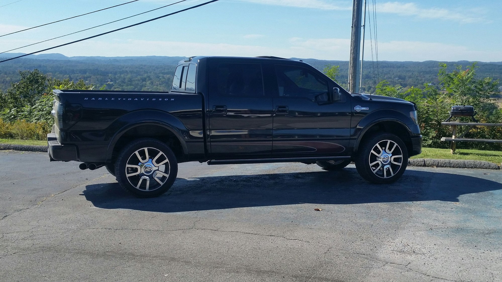

2010 F-150 Harley Davidson 5.4L 3V
I recently did a huge overhaul and installed the Comp Cams Stage 2 Blower Cam with the Cam Phaser Limiters. Sounds Awesome. The custom tune is NECESSARY for the timing to be perfect. I'm very satisfied. Note that as mentioned above, you will be able to noticeably hear the phaser limiters at idle and low throttle....not all the time though. After about 2K rpm the sound goes away completely.
Before and After.
