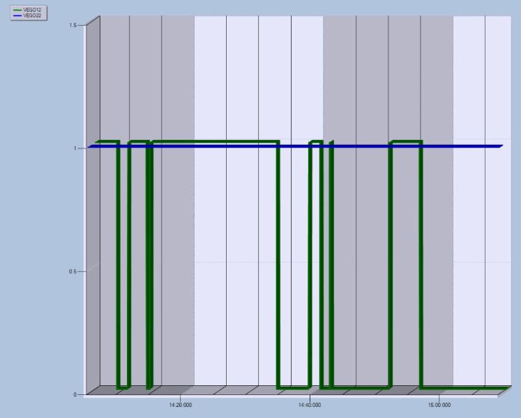

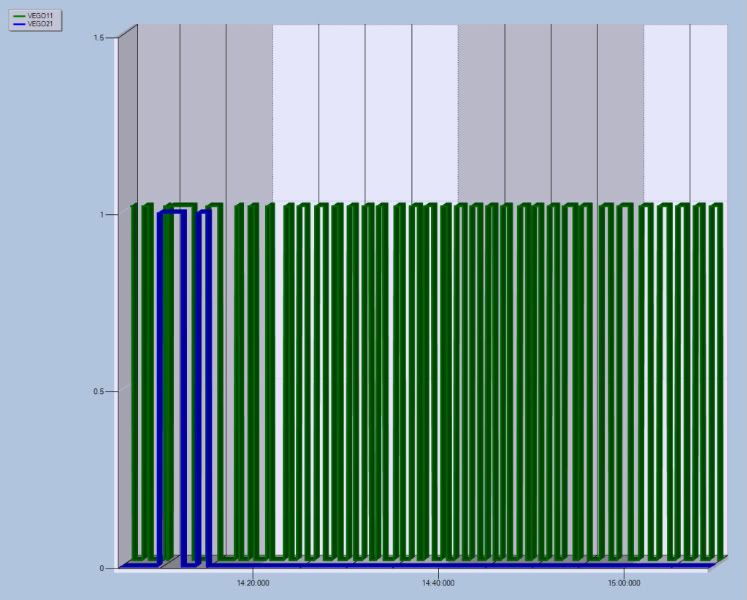

Alright, so the code came back tonight on my way home. I went ahead and data logged the switching of the 02's just to see what they were doing.
Here's some nice fancy graphs of the switching:
Front O2's (Bank 1 = Green, Bank 2 = Blue)
Rear O2's (Bank 1 = Green, Bank 2 = Blue)
So it looks like on the front 02's the bank 1 sensor is switching great, and the bank 2 is barely switching.
On the rear sensors, bank 1 seems ok, and bank 2 seems like it's stuck switched high.
I guess I'll have to crawl under there sometime this week and check all the connectors and wires, plus I'll look around the engine compartment for a vacuum leak while I'm at it.
Bank 1 would be passenger side (1-4), and Bank 2 would be drivers (5-8), correct?

Nice Freeze Frame Data Scruffster. Yea "Green" = Passenger Side/ "Blue" would be the Drivers.
Yea, The same DTC will keep reappearing after reset every-time, after conditions are met. It doesn't always happen right away. I recall some O2 programs have to fail test(s) 3 consecutive before setting one. Looks like you have a problem.
If this problem appeared for the first time, - AFTER working on it, - you can almost bet it's somethings loose.. A bad connection somewheres.
I think it's the O2 connector.
