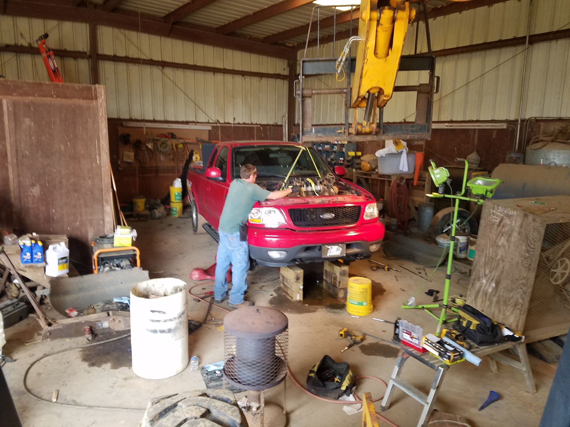

The seatbelts around the exhaust manifolds is the way to do it. My brother bought a junkyard motor and that's the way they did it. We used a scrap ratchet strap. We passed it through a peanut picker spring to center the strap, so we could spin the motor easier.
