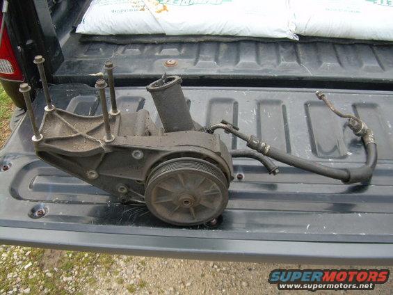

Classic ford PS pump right there. If it bothers you too much, swap the pump.
I tried my luck with a junkyard pump for 20bucks after the '92 sounded like there was a small child in boiling oil under the hood.
Only took a few hours and pretty simple on the older trucks, don't know about the tritons though.
