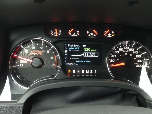

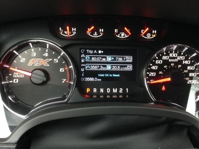

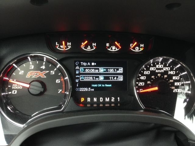

I think something is wrong with mine. I've never towed a thing, I'm getting about 11 mpg or 21 L/100km. I have a 2014 3.5L w/ the 3.73 gears and tow package, supercrew 6.5' box. Its got a 2" leveling kit and some knobby 295's as well but my MPG shouldn't be anywhere near this low. This is also about 80% hwy driving.
Maybe it just isn't broken in yet? It has been getting better, it started at 9.5 mpg when I picked it up.

A few things to remember, if you drive the freeway often, every time you punch it to get up to speed you lower your gas mileage. If you drive the freeway often for relatively short periods then it really kills you mileage because your economy doesn't have time to recoup the hit from punching it. I've noticed going faster than 70 mph starts to really lower you economy. Your mileage should get a bit better as it breaks in. The mpg is very dependent on how you drive. If you are a red light racer your mileage will be horrible. If you drive a little more like grandpa your mileage will be much better.

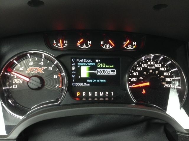

I notice my "instant" gauge shows my MPG at "0" when I am at idle in the drive way or at a light. The L/100km is maxed out at 40 when I am at idle too. What do you guys show when idling?

I believe those knobby 295s are your culprit. I went from P235/55R16 to 265/65R17 and I lost about 1.2-1.5mpg across the board. My truck feels heavier off the line, too.

Of course you're a 0 MPGs when the tires aren't rolling. You are burning fuel but going no where, this is the worst possible mileage you can get. If you were full throttle you would be getting better mileage because you would be going somewhere. The gauge maxes out when you let off the gas and coast because you are moving but using little to no fuel.
Simply put, the gauge shows you how far you get from the fuel you are using not the amount of fuel being used.
