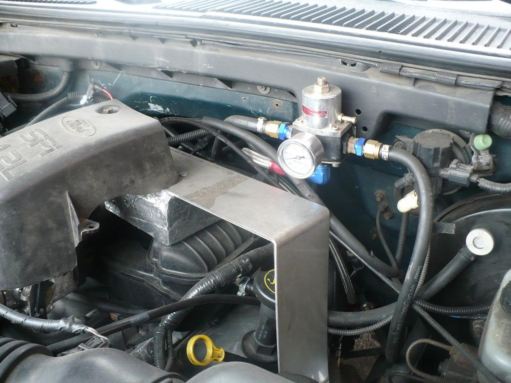

I put an 08 4.2 v6 in my 97 F150. Had to make up the wiring harness put on a 65mm TB, had a spacer made that holds my IAC val, stainless steal bracket made to hold the throttle cable fuel regulator with a return and a few other odds and ends.

[IMG][/IMG]
