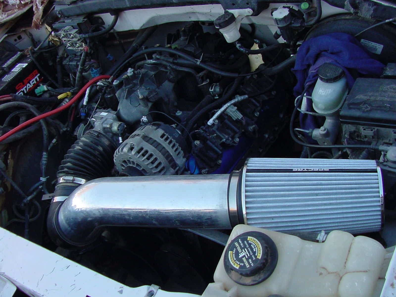

At the risk of being flamed, I went with a 5.3 GM/T56 combo. It was pretty darn simple. The engine is basically stock and I picked up an easy 100 hp/100 ft/lbs over the 4.2....and about 2 mpg increase city/ 5 mpg highway (mainly due to the torque/6 speed combo). Since this is the family truck used for daily driving, camping, vacations, hauling trash and sundry boring family duties, I didn't go crazy with big power add ons. I do have another more serious motor on the engine stand that is propane specific. Going that route when the new year rings in.

Oh yeah...have had it running for over a year. I drive it daily...and on trips. It's a good truck. stengun....not familiar with the "belly button" term but this generation of F150 has most of what I've been looking for. There is plenty of aftermarket upgrades for suspension, brakes and interior/exterior. So I can continue to tinker for years to come. This generation of F150 is the most aerodynamic of any truck built. Generally speaking, I was happy with the truck except for the lack of power and gas mileage the 4.2 exhibited. When it died from hydrolock, it was the perfect opportunity to correct that flaw. The 5.3 packages really well in the truck. Plenty of room to change plugs and work on. I'm not real big on brand loyalty. Let me figure out how to post pics.

The only photo I have at work is the initial mock up photo. The CIA is now packaged a lot cleaner and more functional.
